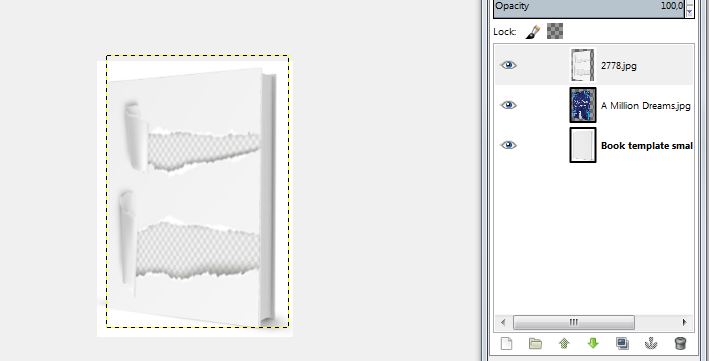

Hi! I hope someone can tell me what I'm doing wrong here... I'm a gimp user on a beginner level (learned only via youtube) and I have managed to make 3D book covers (template book with image cover put over it with perspective), it works pretty good.
Only now I want to have the same but for a cover reveal, so you just see some of the cover of the book underneath. I downloaded an image (free vector) of a rip so now I have the template book, then the cover as a layer and the ripped effect as yet another layer but however I click to change order, I can't see it. Any ideas what I'm doing wrong?
Attachments: * https://www.gimpusers.com/system/attachments/1272/original/Gimp_prob.JPG

Not a gimp problem - quote "I downloaded an image (free vector) of a rip"
From your screenshot, that is a jpg and jpeg format does not support transparency. Best guess is you downloaded an example image, a vector would typically be "something.svg"

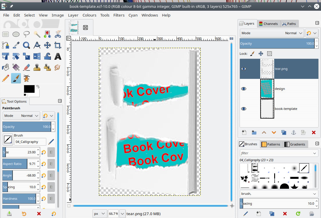

The checker pattern is just a convention to denote transparency. Attached a screenshot jpeg. This captures the checker pattern but not transparency. Open the xcf file of the image to see what it is.
I could not find that vector with a search, so a bit of scaling and erasing from your small screenshot. Not wonderful quality.
You can add transparency to that 2778.jpg layer Layer -> Transparency -> Add Alpha Channel From the screenshot it already has an alpha channel. You can tell by the layer name, bold - no alpha, light - with alpha.
Having an alpha channel does not recreate the transparent (checker pattern) areas. You will have to erase those to show what is underneath.
Much better way if you have the svg. Open as layers, set to the correct size for your template (avoid scaling later)
Attachments: * https://www.gimpusers.com/system/attachments/1273/original/no-trans.jpg * https://www.gimpusers.com/system/attachments/1274/original/book-template.xcf

Thank you SO much for your reply and help, it's much appreciated! I will search for a svg file instead, it does sound much easier to me than erasing areas (not sure how to manage that), and try again. My other images are jpeg so I didn't think to use another format and I didn't know they wouldn't work.
