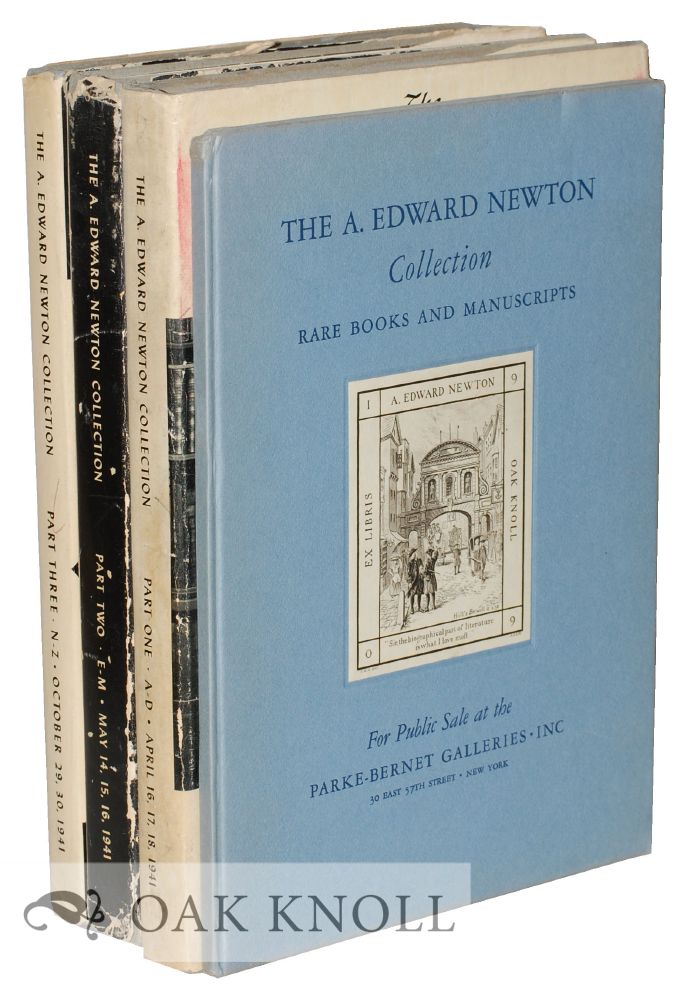

Hi. Is there a simple method (not using inversion, etc) by which I can create a floating image of a book. I know it can be done but for the life of me, I can't figure it out. I would be so grateful for some help. I've attached an image. What I would like to be able to do is select the volume in the upper part of the image and have it be able to float on a black or white background. I should add that I know how to do the few things I need to know how to do on Gimp, but nothing beyond that. Thanks very much.
Personally, I have a hard time figuring out what "floating" here means.

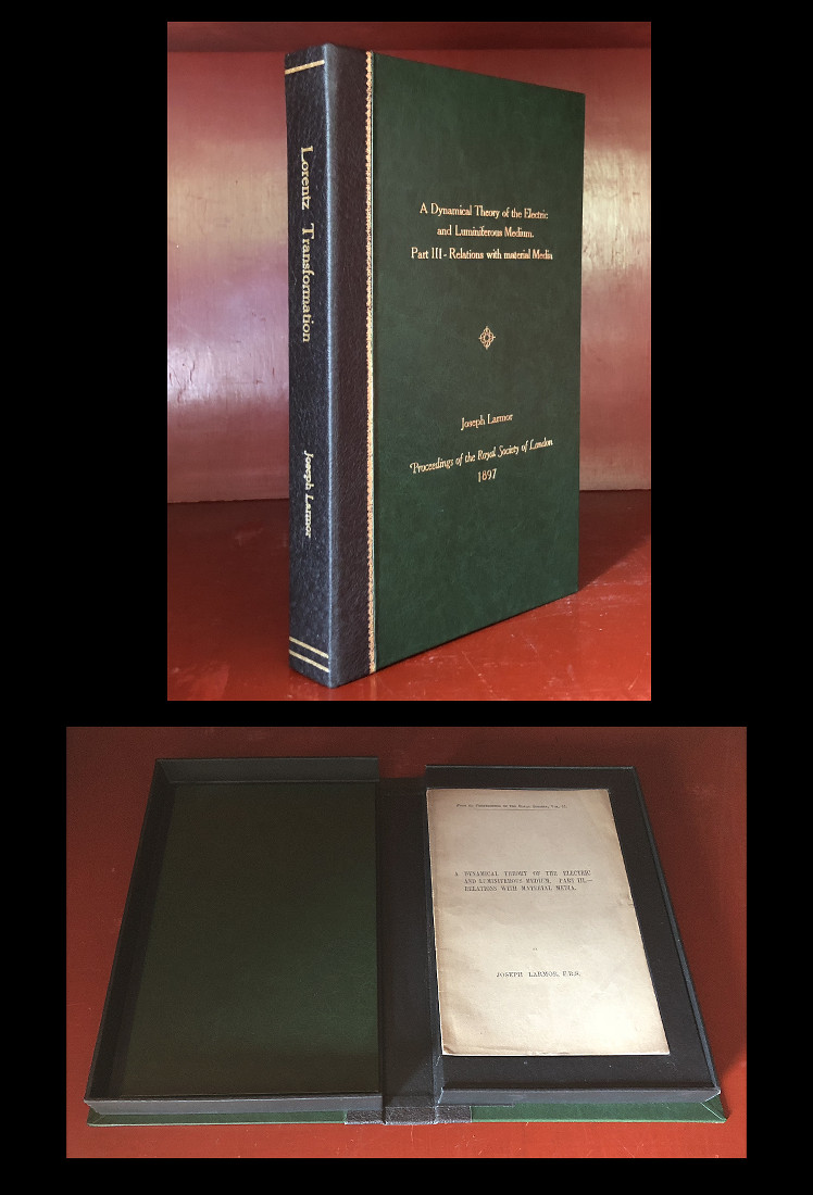

IN ADDITION TO MY FIRST IMAGE, I'VE ATTACHED AN IMAGE TAKEN IN WHICH SOMEONE WHO KNOWS WHAT THEY ARE DOING HAS SUCCESSFULLY 'CUT' OR CARVED OUT JUST THE IMAGE THEY WANTED, THEN SET IT ON A WHITE BACKGROUND. THANK YOU SO MUCH FOR YOUR HELP.

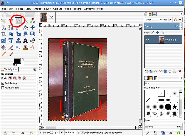

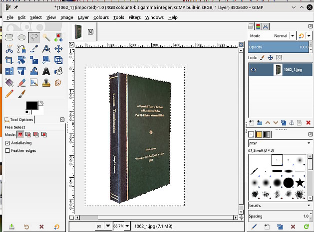

Do a search for Gimp + remove background or Gimp + extract foreground, the two are roughly the same, depending on the image.
For a book with straight edges, use the free select tool clicking in the corners produces straight lines. as screenshot 1
When complete, Invert the selection, Select -> Invert fill with white (or black) screenshot 2
Then turn the selection off. Select -> none
Any number (and better) ways
Ok just re-read your post and you do not want to invert a selection (why??)
Make the selection
Copy it
Paste it into a new canvas of suitable colour.
