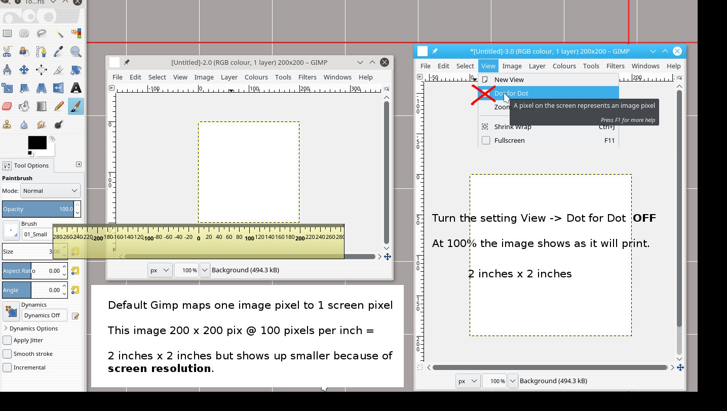

First and most important. Gimp is a raster editor and works in pixels. It can show cms as units for your convenience, but it still works in pixels.
If you are not sure about the printing size. Check Image -> Image Properties and that shows information: Size in Pixels / Print Size / and Resolution (ppi)
Another way is turn off View -> Dot-for-Dot see: https://docs.gimp.org/en/gimp-view-dot-for-dot.html
Providing the screen resolution is correctly set then, at 100% the image displays as it is printed. See screenshot

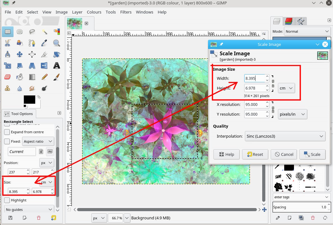

Second Question. Not sure what you want.
A selection can be set to show centimetres in the tool options. Use the value from that selection to enter into Image -> scale image. You might have to break the link if the width / height proportions are different. See screenshot
dot-for-dot
use selection value
When I use the scale tool, I can see the dimension in pixels of my selection. I can also switch the unit and see measurement in mm. When printing this image, will I get the mm annouced in Image --> scale image ? Which are the same seen with the scale tool by the way. Because if I get what I have at the screen, it will be much smaller. Indeed, taking off the dot for dot, changes quite a lot the visual dimension. And it is much closer but still different... The screen resolution seems to be good though... I don't understand the difference between the image properties and the measurement on the screen...

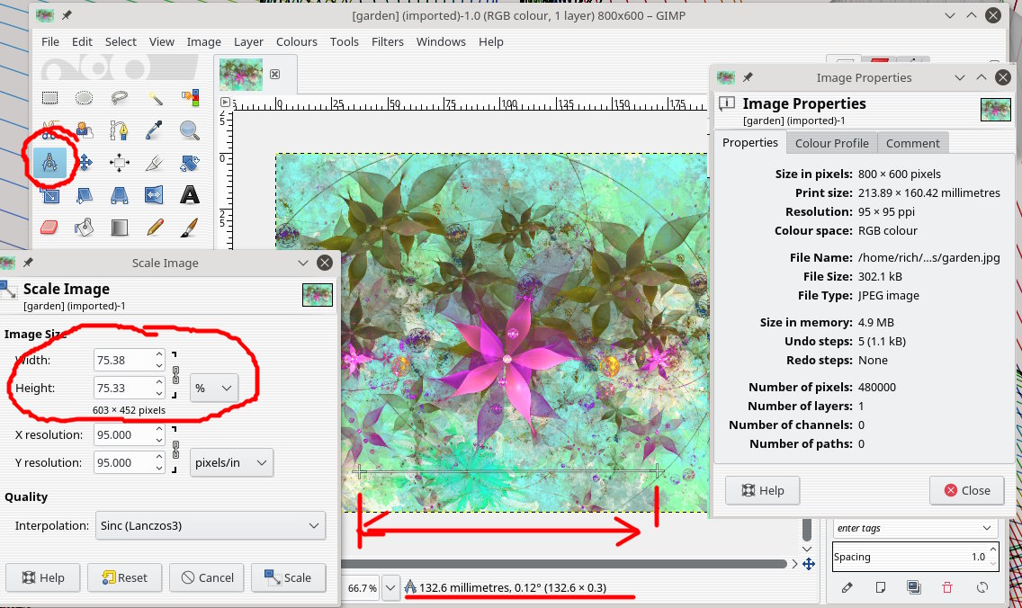

I am trying to resize an image according to an image detail (the rule in my exemple) of which I know the size. When I select my detail reference, and set the dimensions with the scale tool, what I get is the resizing of the selection. The rest of the image is not resized at all. What I'd like to have is a homgenous resizing of the whole image thanks to the detail reference. To say it differently. I'd like to say to gimp : "resize the whole image knowing that this little detail is 100mm long".
It is possible but you will have to do some arithmetic. use the gimp measure tool
https://docs.gimp.org/en/gimp-tool-measure.html
Measure the distance on the image - the example is 132.6 mm needs to be 100 mm scale factor is 100/132.6 As a percentage 77.4% There is a small error because Gimp has to fit it to ***pixels***. see screenshot

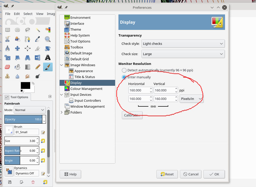

The other question on screen resolution. Has to do with the monitor pixel density.
There is a setting Edit -> Preferences -> Display. Gimp might not get the automatic setting correct. Sometimes you have to set it manually. The screenshot shows my HD laptop (1920x1080) settings.
measure the image
display resolution

I tried to figure out how I could get the same result by only changing the ppi. Is there a calculation that allows to get the same result that with the first method ?

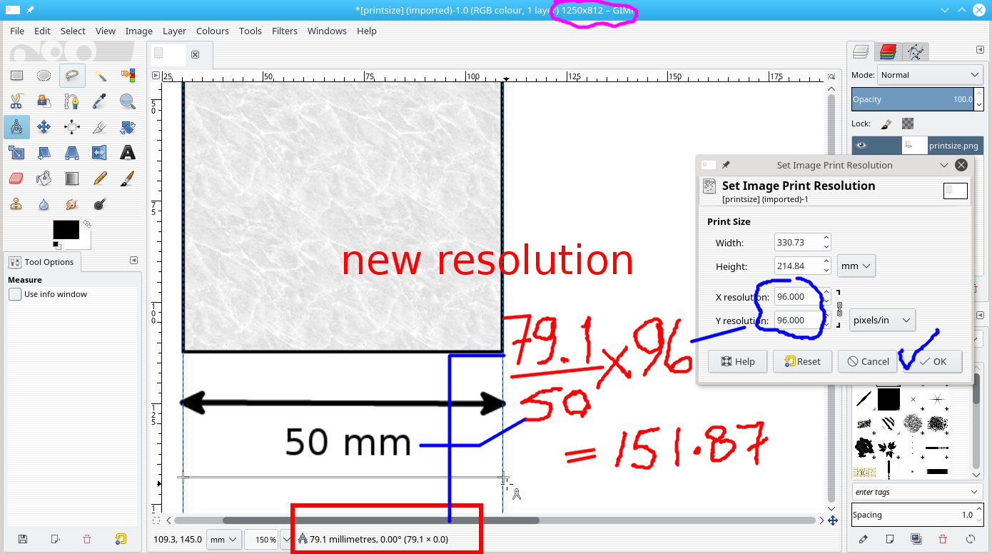

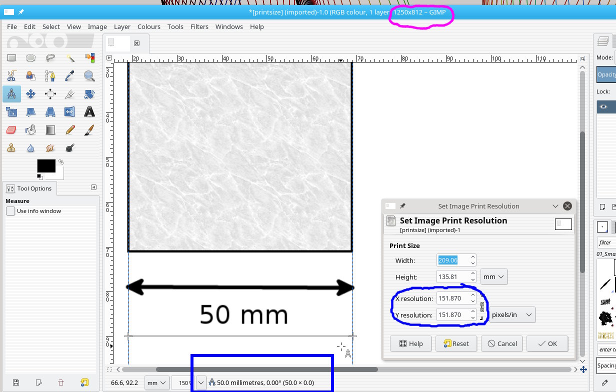

A simple proportion calculation similar to scaling the image.
Open the Print size dialogue: Image -> Print size and note the print resolution.
Use the the measure tool to get a size for the known dimension.
Then it is measured size divided by known multiplied by existing print resolution. see example.
Enter the result in the print size dialogue and ok it
Check the known dimension again with the measure tool. see example.
Note that the size of the image - top of window - remains the same. the image has not been scaled only the information sent to the printer.

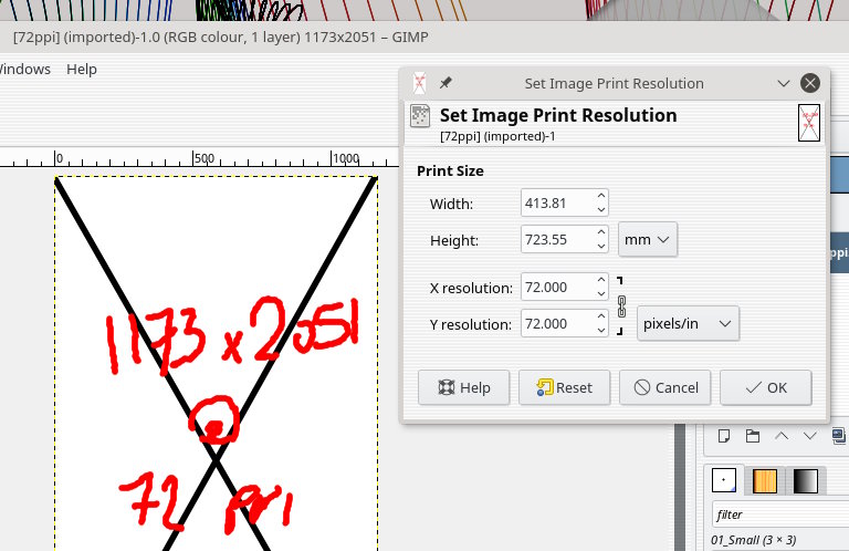

Ok here is the actual size of the image : 1173 x 2051 pixels
Printing size is : 413.81mm * 723.55 mm
And I want 201.6mm * 351mm
(413.81/201.6) * 72 = 147.789ppi
(723.55 / 351) * 72 = 148.42ppi

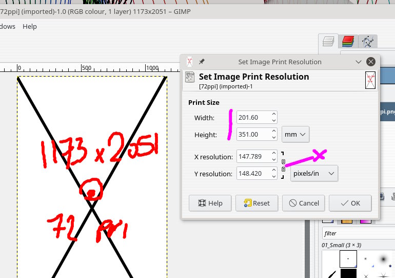

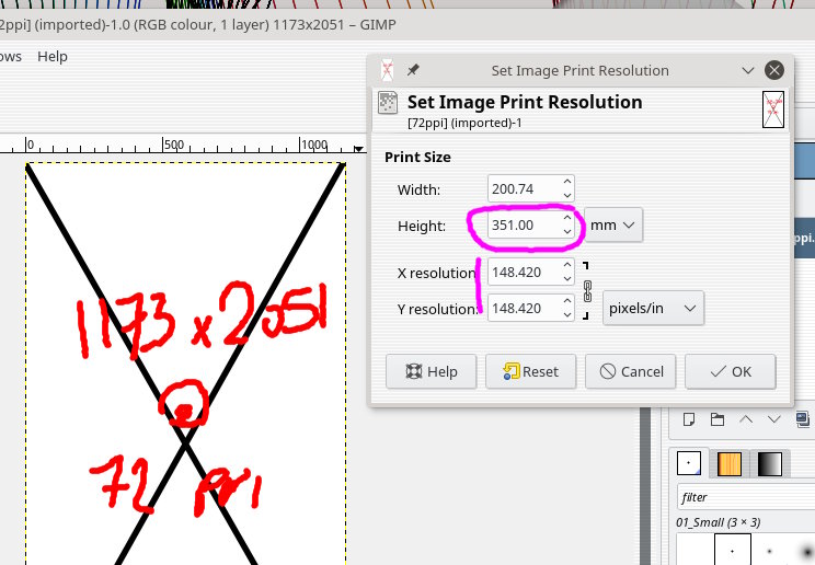

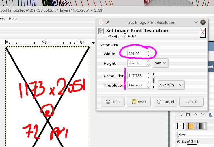

Original size 1173 x 2051 pix @ 72 ppi - Required print size 201.60 x 351.00 mm
Open the Image -> Print Size dialogue. see: screenshot 1
The pixel size proportions and the required size proportions are not a perfect match
The options -
set the width to 201.6 height is a little off (352.5) see screenshot 2
set the height to 351.0 and the width is a little off (200.74) see: screenshot 3
You can break the link between x and y resolution and have 201.60 x 351.00 mm This is ***never*** a good idea. It creates distortion in the image. see: screenshot 4

Ok thanks
This is what I got too. I accept distorsion in my image. So it's ok.
Thank you very much for the time you have spent to give me all these explanations. This was very helpful !

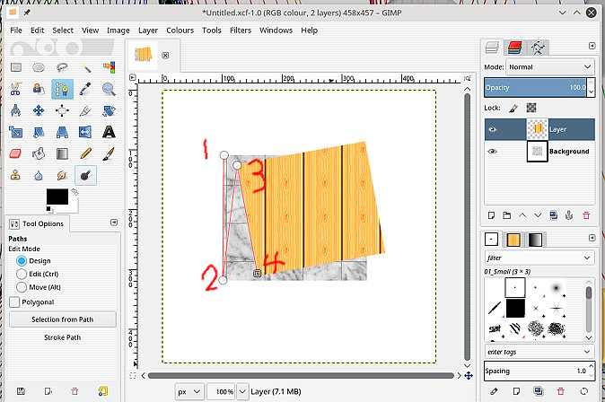

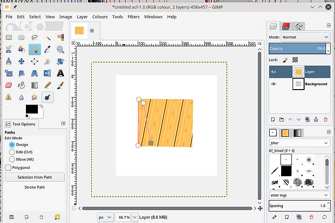

You can go back to the first posts.
Gimp is a raster editor that works in pixels. If you use the measure tool between two defined points and it is 100 pixels in first image and 120 pixels in second image then to match, one of the images has to be scaled in the ratio 100:120
Another way is adding images as layers. When you open the first image (base layer) then **open-as-layers** a second image. The second layer takes the properties of the first image. The second layer can be scaled in place.
I am not sure if this is what you want but layers can be 'matched' using plugins, it is called image registration.
This example uses a plugin ofn-layer-aligner.py from http://sourceforge.net/projects/gimp-tools/files/scripts/
The top layer in screenshot 1 is rotated and scaled to match the base layer as screenshot 2. Notice how the whole layer is scaled (dotted line) and could be lost if you do not resize the canvas.
If you are going to put 3 images side-by-side in a jpeg obviously a bit more work is required. But the earlier comment still applies. The additional images will take the properties (ppi etc) of the first opened image.
