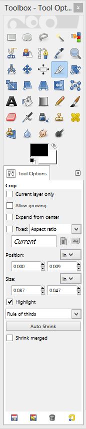

Hi I would love some help with this one please.
I am trying to do a simple crop to 8*10 in GIMP I have attached a graphic of the settings
Fixed is unchecked Size set to inches
I am selecting the rough area that I want. I am then putting the dimension into the size variables and then GIMP changes the values.
I would love so help on this please it is driving me nuts!

Remember that Gimp is a raster editor and works internally with pixels and not real-world units.
However, you are using inches. In the crop tool options
Ignore the fixed option, that works with pixels.
Make a crop area on the canvas, anywhere, any size.
1. Position; set the values to 0 , 0 Click in the little box and you can edit these values.
2. Size: Set the units to inches in the drop down box
3. Size: Set the Size to 8 and 10.
The crop adjusts as screenshot 1.
4. With the crop tool still active, click in the canvas and move the crop area as required.
screenshot 2
That is why I suggested setting the origin to 0 , 0
If the extent of the crop area is outside the canvas, then the crop size value is adjusted accordingly.

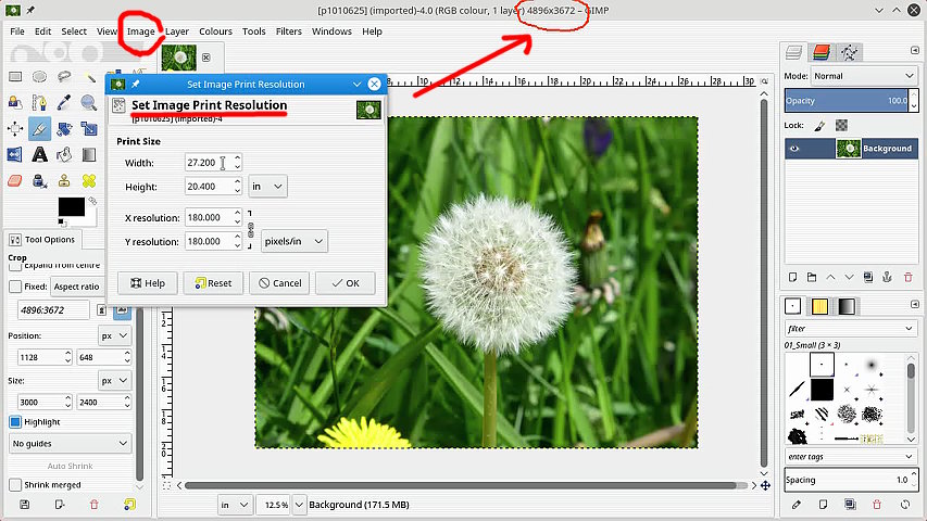

The image was taken with a Cannon 7D DSLR so I find it hard to understand why the image is so small that I can not crop it to an 8*10 .
That camera has a 18MP sensor and should produce images around the 5000 x 3600 pixel mark. Of course you can set a camera up to take much smaller sizes but my guess is you have got a built-in thumbnail rather than the actual image. What format is the image, jpeg or RAW (.CRW .CR2)?
If the image format is RAW then use the Canon software that comes with the camera to convert it for editing. There are plugins for Gimp that handle RAW images but the camera makers software will be best.
Upon further investigation (changing the ruler measurement to inches) it appears that the size of the file is less than an inch in each direction.
The attached screenshot is my 18MP lumix. The important bit is the size in pixels at the top. Then go into Image -> Print Size and see what it says there. Come back and give the equivalent values of your image.
All I want to do is produce a photo that will fit into an 8*10 frame...one frustrated user ;-)
I could write a 1000 words on this but I am not going to. This little video shows it all in 4 minutes.

Do not expect Gimp to work the same way as PS. The Gimp crop tool fixed size options work in pixels. If you want 200 ppi set the size to 1600 x 2000 pix. Otherwise use the print size dialogue.
I watched the vid. first off he changes the ruler sizing to inches with some feature below, which I don't have. then he goes into print size?
Believe me you do have that feature, not my fault if you can not be bothered to find out how Gimp works.

You still have not given the image dimensions in pixels yet. Not difficult. It is at the **top of the image window**
From your posts, best guess is still you have opened a thumbnail instead of the full image. Can happen with Canon .CR files. especially if they are corrupted somehow.

8"x10" at 200 ppi is 1600 x 2000 pixels.
If you can crop the image to this size and get what you want, you do not need additional steps.
If you do - i.e. if a 1600x2000 crop does not match up with what you want to crop out of the original image - then a scale will become necessary.
Can you provide a sample image and mark the area you want to retain after the crop?
There is an unit drop-down list in the image window status bar - check the View menu. This can also be set in GIMP's preferences.
Maybe to adjust the image resolution.

Help with Cropping
You CAN work in inches and your title bar can be changed to show the original size in inches.
No need to work in pixels.
See attached jpgs.
Of course, small photos have to be scaled up to get larger sizes. GIMP scales up quite nicely.
Rick S.
