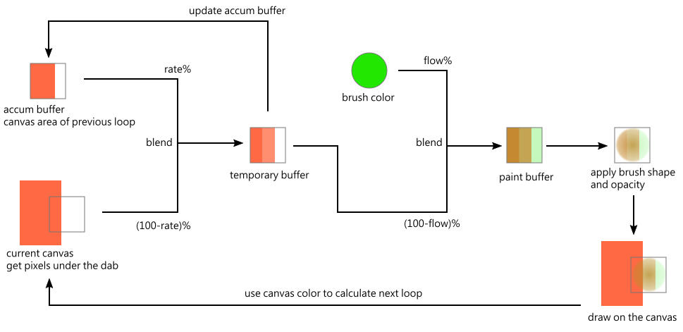

Hi everyone, I made an experimental tool : A customized smudge tool, which can not only smudge the color on the canvas, but also blend brush color on it. Because I thought this can make a different taste from "Watercolor" type smudge when drawing images. (I mainly use GIMP for digital painting, so the power of a brush engine is important to me.) I did this by modifying the code and building by myself.
(See the "Parameters" image)
I added two parameters. One is "Flow", which controls the amount of brush color. The more it is, more foreground color will be blended. Of cource it can be controlled by brush dynamics. (To simplify the work I picked a currently-unused parameter and didn't make a new one.)
The other is "No erasing effect". If enabled, if smudging will decrease alpha of some pixels, don't decrease them, thus doesn't erase existing pixels. This is useful to fill the gap between two color areas.
Currently I made this just for experiment and it's not very robust. If someone wants to make this as an official feature, I am glad to help. (Not sure whether I should post to gimp-developer mailing list or not...)
The attachments are some tests
"Simple tests" Also compare this smudge tool and MyPaint brush(which is watercolor type smudge). It's better to keep Flow under 30, or control it by dynamics. Otherwise it will be nearly the same as normal brushes.
"By customized smudge tool" and "By MyPaint brush" are two artworks with similar painting method, only different tools. (Tip: smudge tool is very useful to draw hair and flame)
And "No erasing effect" shows why this parameter matters. In the left image, there are transparent gaps between dark gray and red areas. Without "No erasing effect", smudging on the gap will diffuse its transparency to nearby pixels and it's difficult to remove the gap. "No erasing effect" may also be useful in watercolor type smudge. Havn't tried yet.

Here is my inspiration:
Commonly there are 2 types of smudge tools in paint softwares. (See images)
"A. Type 1" Copy an area, and paste to the next dab. Examples: GIMP's smudge tool, "Finger" tool in many softwares.
"B. Type 2" Calculate the average color in an area, and fill the next dab.
And if we add coloring ability to Type 2, this forms "Watercolor" tool in many softwares.
For example, this is the algorithm of MyPaint's smudge.
"C. Type 2 with painting"
Similar examples: Watercolor in Paint Tool SAI and many Japanese softwares, Krita's color smudge brush with dull mode.
For a long time GIMP had no such tool, but newly added MyPaint brush in 2.9.4 filled this gap.
But how about Type 1 with coloring ability? Few softwares have it. The only software with this tool I had ever seen is Krita (color smudge brush with smear mode).
So I modified GIMP's smudge tool, followed MyPaint's algorithm. "D. Type 1 with painting"
And as I drew above artwork, I found that "No erasing effect" parameter is necessary so I added it.

Sorry for misplacing the images.
The B. and D. are exchanged.
I did this by modifying the code and building by myself.(See the "Parameters" image)
It's better to keep Flow under 30, or control it by dynamics. Otherwise it will be nearly the same as normal brushes."By customized smudge tool" and "By MyPaint brush" are two artworks with similar painting method, only different tools. (Tip: smudge tool is very useful to draw hair and flame)
