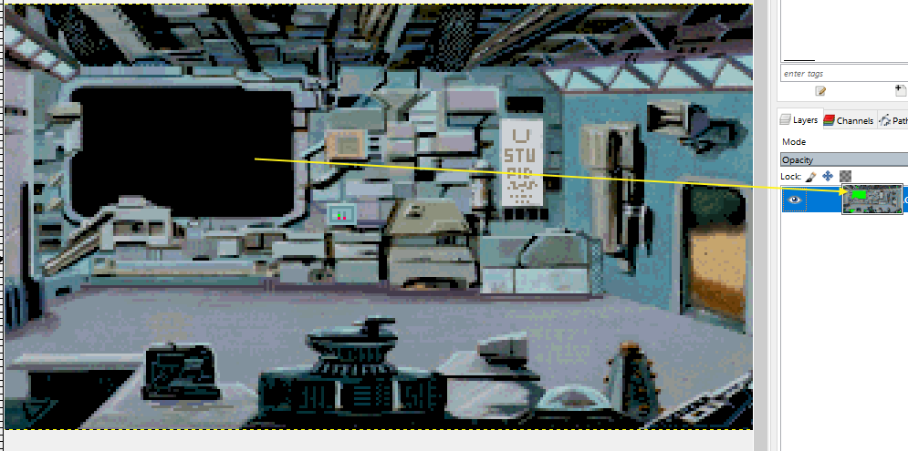

I have an indexed PNG image. When I load this image to GIMP, I observe an unexplainable effect. Some black parts of the image are displayed in bright green color in the 'Layers' section. I assume these black parts have some special properies. Could you, please, explain me the origins of this effect?

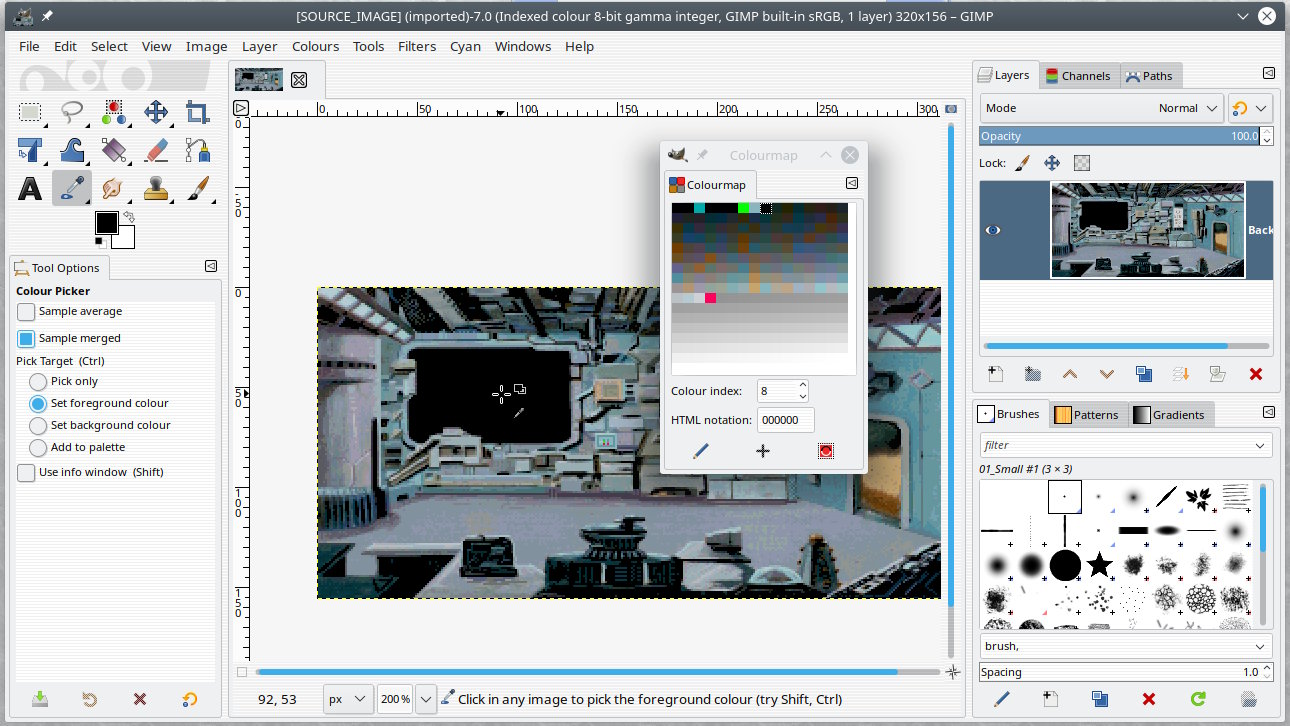

Interesting. Looks like a bug in the way Gimp 2.10 renders the thumbnail. Increase the size to "Enormous" and it is back to black. Also black in standard Gimp 2.8 thumbnails. (and if you change to RGB mode)
The black area is definitely black in the colour map.
