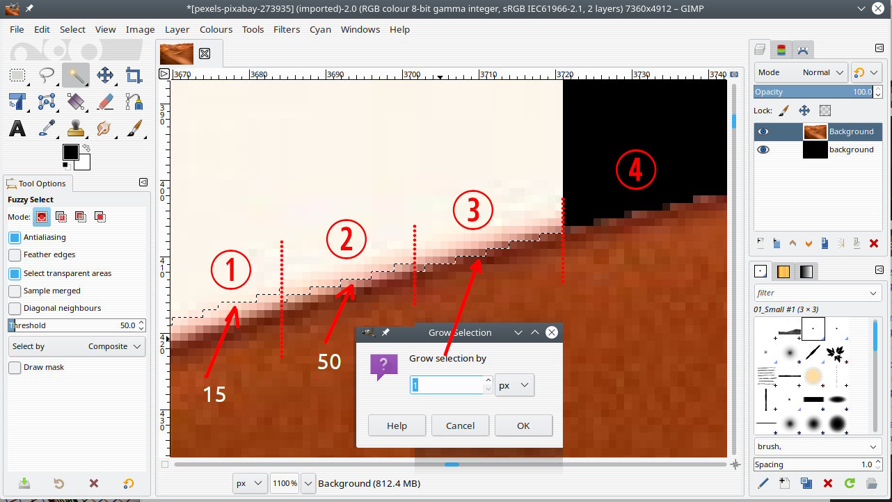

It is important that you consider each image individually and not just 'one-size-fits-all'. The border between land and sky contains 'anti-aliased' (semi-transparent) pixels, also a jpeg image will contain jpeg compression artifacts. A very common fix for this type of selection. see screenshot.
1) The default for fuzzy-select threshold is 15. That leaves that border of light coloured pixels you are seeing.
2) An improvement is made by increasing the threshold value , say to between 50 and 80. Still not quite there.
3) Select -> Grow selection by 1 or 2 to get a selection boundary on those solid pixels.
You can mix those steps, often a selection and a grow by 2 or 3 pix works. Not too much though, or you will get a 'jaggy' border.
Thank you...
Select -> Grow selection This did the trick and solved the problem I was having. The default in 2.10.20 is "5 pixels" and that worked on the first try.
