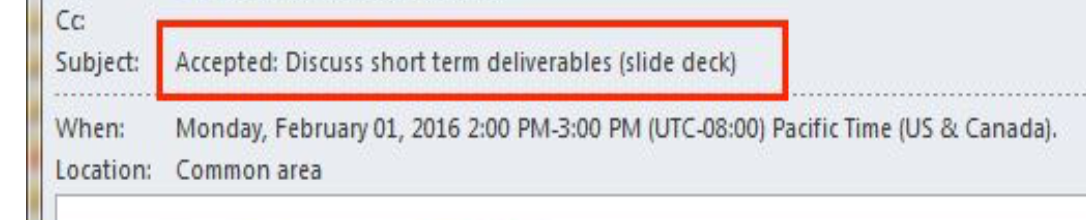

Hello all,
I've tried watching some YouTube tutorials to figure out my problem, and I've also done some searching but can't quite figure out how to accomplish my goal. I'm a novice still and part of my problem is that I'm not well-versed in graphics concepts, so I think I'm not comprehending some of the explanations.

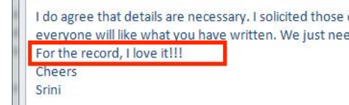

I have several images which are just screen grabs or PDFs. For example, the one attached is from a PDF which contains annotations (red rectangle). I can import the PDF as a JPEG, that's no problem.
I'm trying to remove the red rectangle and in its place just have the "background" that was there before the red rectangle was added.
If someone could just point me in the right direction... a tutorial, part of the user's guide, whatever, I'm happy to go dive in.
Some of the YouTube tutorials showed adding layers, turning the image to gray scale or black-and-white, reversing foreground and background, etc. My head was spinning. They went kinda fast for a novie.
One of these days I'm going to start from the very beginning and learn this great tool from the perspective of concepts and formal immersion into the graphics world.
Many thanks in advance...
Trying a very non-complex approach:
Use the color picker tool to pick up the background color, then use the paint brush with an appropriately sized brush to paint over the rectangle.
* https://www.gimpusers.com/system/attachments/1306/original/Screen_Shot_2019-11-30_at_12.01.51_PM.png
For that image, the method above is quite fast, except for the area around the h in Cheers.
The text in the screenshots shows some sub-pixel hinting artifacts, for better screenshots it might be wise to turn subpixel hinting off before taking them, or make sure this is done by grayscale pixels only.
You should specify how many images your "several are", and how many annotations your are going to remove from each on average.
Also, avoid JPEG for anything but the final exports - using this format introduces artifacts around every edge, and will complicate your task needlessly.

Ah, thank you, Michael. By "several" I mean about 6 or 7 files... no big deal. In most of the files there is only 1 red rectangle.
One thing I forgot to ask... In another image I have (I attached a screen grab of part of the PDF), there is a dashed or dotted line in the original JPEG. I would like to "recover" the dashed line upon removal of the red rectangle that was drawn "above" it; that is, upon removing the red rectangle I would like the result to show the dashed line as if the red rectangle was never added.
How would I do this? I'm not sure how I would use the technique you suggested for this case.
Finally, what format do you suggest using other than JPEG?

OK, I figured one thing out.... how to re-add the dotted line... 1. I selected the rectangle select tool. 2. I drew a rectangle around a section of the dotted line that remained. 3. I did a Copy.
4. I drew another rectangle around an area where I wanted the dotted rectangle, again using the rectangle select tool. 5. I did a Paste.
6. I adjusted the placement slightly.
This seemed to work. Although I'm not sure this is the "best practice."
