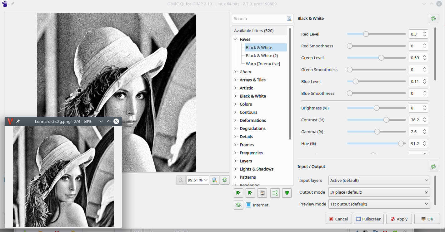

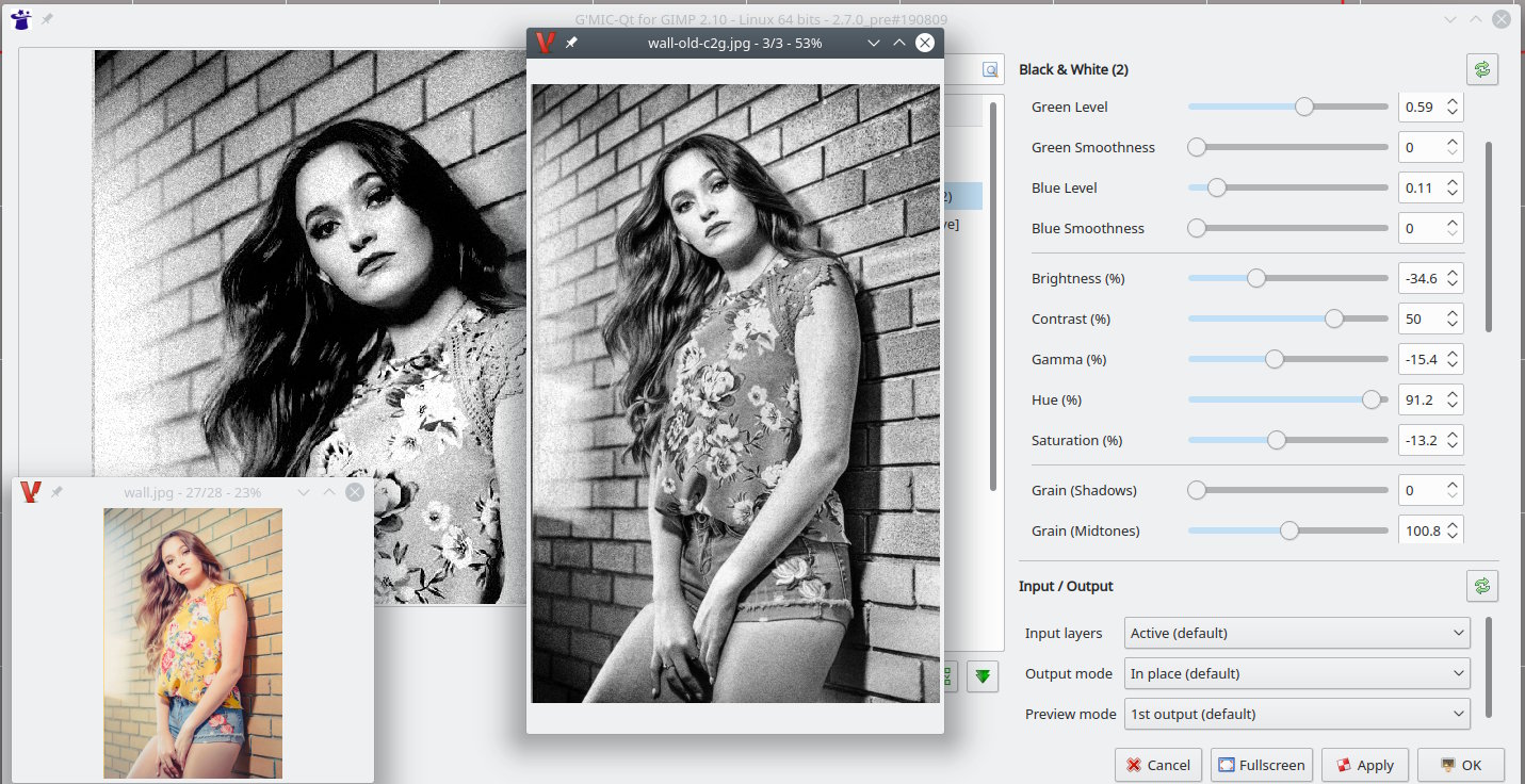

FWIW - You would have to ask the developers (Maybe you already have?)
The closest I can get is the gmic_gimp plugin and the black-and-white filter
but....
It is not consistent. A darker image requires slightly different setting for contrast and gamma than a lighter image and if you do not know what a Gimp 2.8 c2g looks like, then it is a matter of judgement.
screenshot examples have the Gimp 2.8 c2g as an inset.
The only advantage with gmic_gimp is
1. Your can save settings to recall them at a later date.
2. It is scriptable.
best of luck with this one.

thank you, rich404, for this information ! i didn't know about this gmic_gimp thing - good to know !
now, short question : the large examples you show are processed within gmic with some manual desaturating techniques, correct ? you are not using any c2g algorithm in gmic as we used in gimp 2.8, right ? one definitely sees a wealth of more information in the small inserts or insets as compared to the big pictures !

The gmic_gimp plugin, www.gmic.eu does not use c2g (or GEGL) in anyway. The larger images are the gmic dialogue preview that gives a live (not always exact) view of the parameter changes, and there are a lot of parameters in the Black & White filter. All you can do is try it. Maybe not as good as c2g but....
For better information ask on the pixls.us forum. https://discuss.pixls.us/ where the gmic developer resides. It is largely a photographic forum and you will get better advice than I can give.
