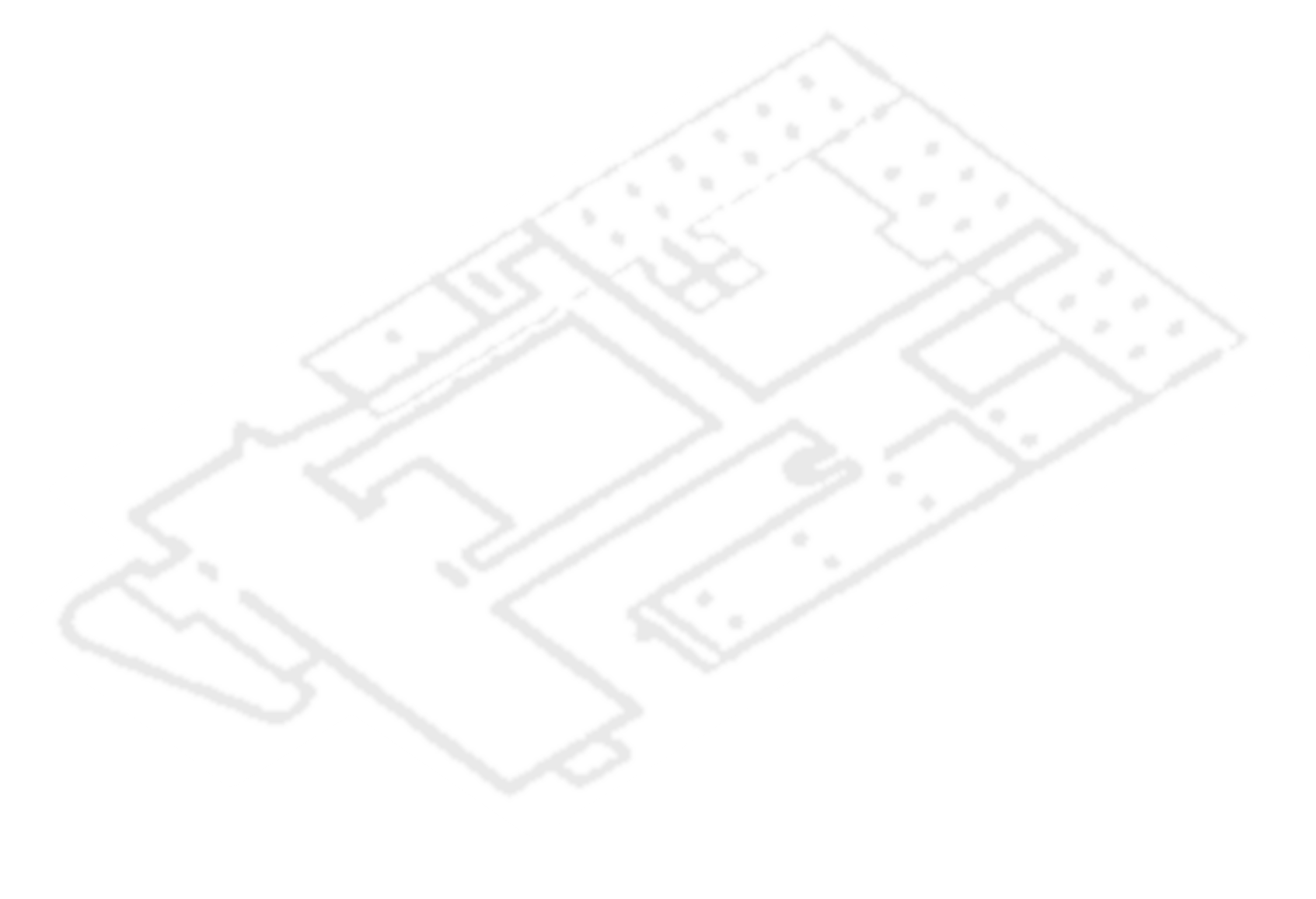

I've noticed that if I try to move a layer that is really faint I can't. It seems like it's too pale for the move function to "grab" onto - the cursor is supposed to change from the little hand pointing an index finger to a 4-way arrow when it "grabs" onto the current layer that is to be moved but when the layer is really pale the cursor never changes. Sometimes I can fix this by decreasing the brightness and/or jacking up the contrast of the layer but with this one image I'm working on the contrast isn't working. When I'm moving the Contrast slider bar up I can see the layer change but as soon as I hit "OK" it reverts right back. I change it with Brightness but not Contrast. I've tried first making the layer darker using Brightness then increasing the contrast but the contrast still keeps reverting when I hit "OK". What am I not understanding here? Any ideas?
I've attached an image of the layer that's giving me problems.

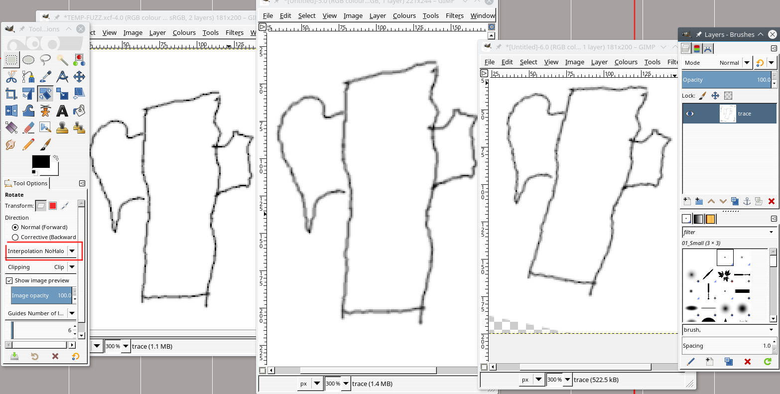

I was not going to reply since I can not reproduce the fuzziness. Plus really insufficient information.
An annotated jpeg is not enough. A xcf is better, with the various layers but also depends on brush used, degree of opacity, layer modes, interpolation method. All these just the same info as required for Gimp 2.8
However, a bit of pixel counting and I reckon a very small brush used, maybe two pixels. Did you use a graphics tablet? A trace around your original and a scale (122%) and a rotate (12 deg) gives that first screenshot.
Not noticeably extra fuzzy, a bit of extra anti-aliasing on the rotate which might be expected in any graphics application.

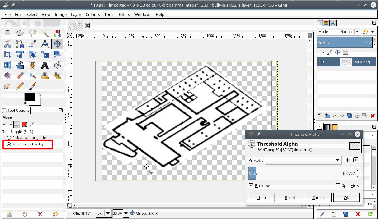

Your very faint outline. My guess is you tried to reduce opacity so that some layer below shows through. Not going to work. A threshold-alpha shows the problem. (so does your attachment on my browser) Try a color-to-alpha on the original.
Moving the layer. Just the same as Gimp 2.8 If you pick a transparent area gimp homes in on the next solid pixel down. Use the "move-the-active-layer" toggle in the move tool.

The reverting back to original is a bug of sorts, Basically Gimp 2.10 should not show the change in the first place. It should show same as Gimp 2.8 - nothing for this sort of image. It will be fixed in Gimp 2.10.10 (I am told) or In Gimp 2.10.8 up the precision to (I think) 16 bit floating point.
