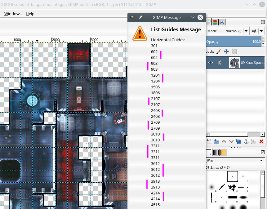

It is not the plugin, it is your image and in particular the guides. Many duplicates, see screenshot
Remove all of them, and replace at the 301 x 301 pix spacing. Attached a script for multiple guides, guides-grid.scm and the script listguides.scm
You also have an active selection there, does not affect py-slice.py but not good practice.

This worked perfectly thank you for the help and for the plugins, that'll be a lot easier than using guides by selection while snapping to a grid. I didn't realize that would cause double ups.
