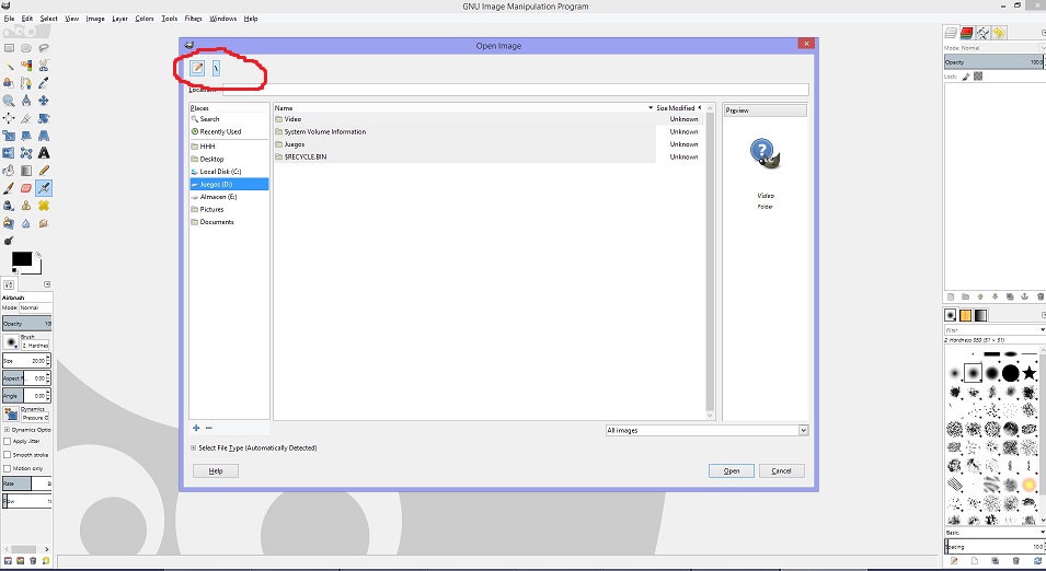

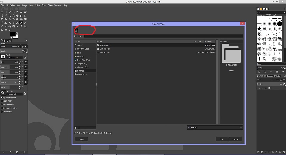

I just installed GIMP 2.10 and when I try to open or save an image it doesn't allow me to browse my hard drives and the option on the top to navigate through folders is not present.
Then uninstalled 2.10 and installed again 2.8.22 and everything was fine.
Installed again 2.10 but still the directories are not showing. If I click on the user folder it will show the content but won't let me go up directories.
I'm running it on windows 8.1.
Any idea of what is happening? I searched for a solution but could not find any answer.

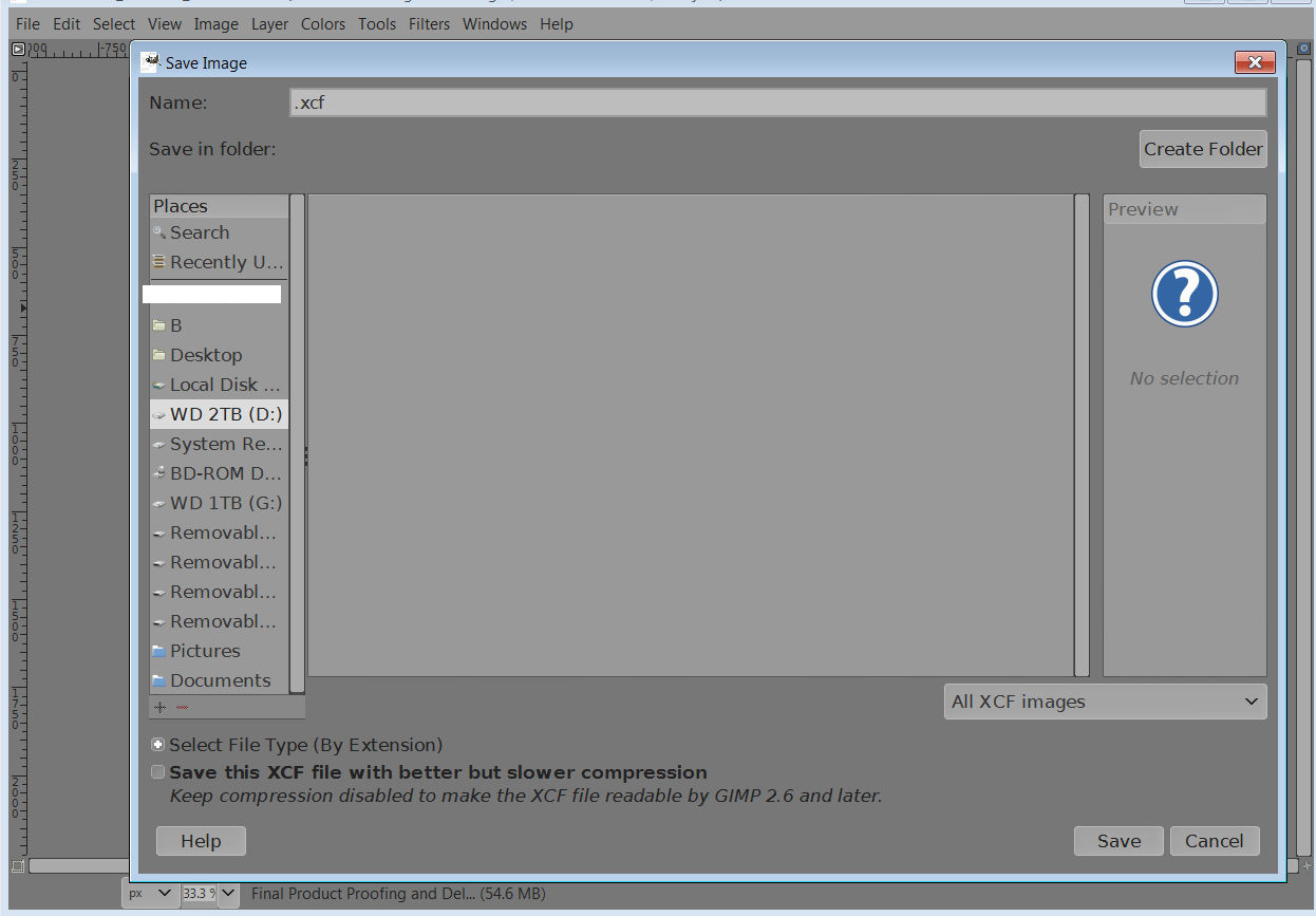

I'm having the same problem. I did a clean install of Gimp 2.10 and deleted the previous 2.8 install directory before the new installation. When I click on my different hard drives and directories in the Save As dialog the only files or folders shown are in Pictures, Documents and the current User directory, all of the hard drives show blank and I cannot navigate them. It's hard to imagine that one would need to install a different package other than the official Gimp one to get something as simple as save directories to show up when trying to save. Any help would be appreciated, thank you.
Attachments: * http://www.gimpusers.com/system/attachments/908/original/Untitled1.jpg
-- Poptop (via www.gimpusers.com/forums) _______________________________________________ gimp-user-list mailing list
official
Gimp
trying
to
Attachments: *
