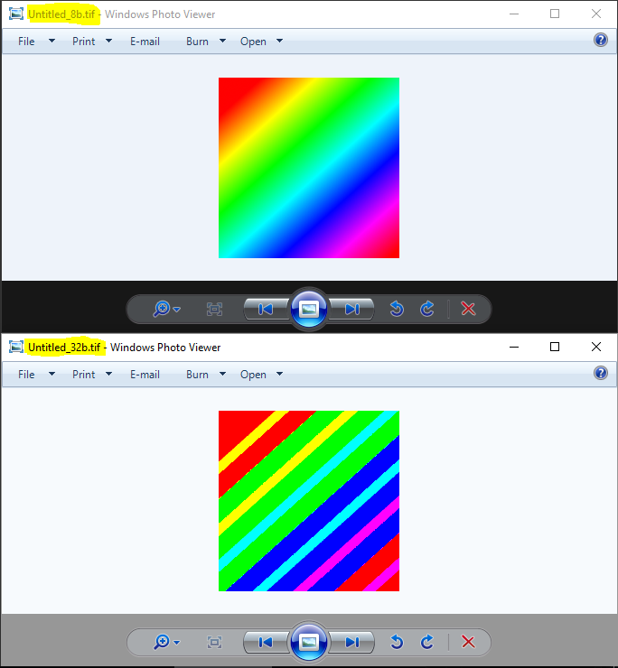

Hi, I just upgraded to the latest GIMP (2.10.0) and I am very happy with the update, however I have an issue that I can't seem to resolve:
When I am exporting my file to TIFF format, from my 32-bit precision GIMP file the color information seems to be corrupt (or goes back to 4-bit precision), as can be seen in the comparison screenshot attached. - Whenever I export to tiff from a 8-bit GIMP file (same as in the previous GIMP version) everything seems fine. - Whenever I export to jpg, png or pdf from my 32-bit file, everything is fine.
I have tried to reproduce my findings (successfully) with the MWE in the link below:
https://drive.google.com/open?id=1Av0LBrVf7NBKnu9odO2DO68v5VL7zt_M
All help is welcome!

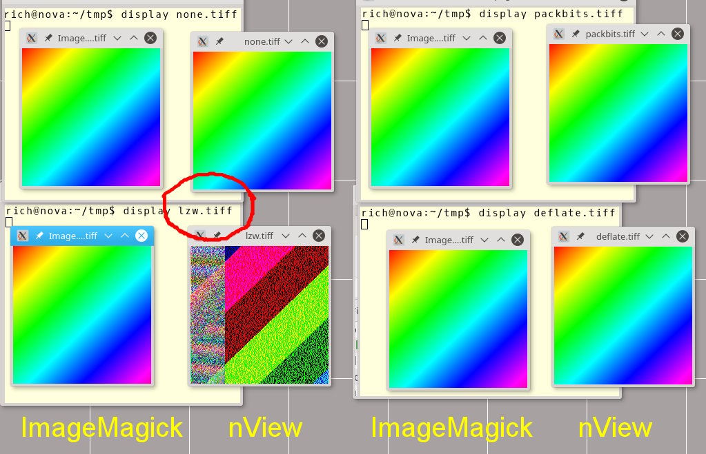

Could be Gimp, could be the Image Viewer.
I use linux so can not comment on the Windows Viewer but two different linux viewers and the four different compression modes that support 32 bit.
ImageMagick works on all four - nView scrambles the lzw compressed tiff.

Thanks for the reply.
Indeed when using ImageMagick Display, I can actually see everything. Now I hope that the concerning file can be printed correctly. I'll make an 8-bit backup file to be sure.
