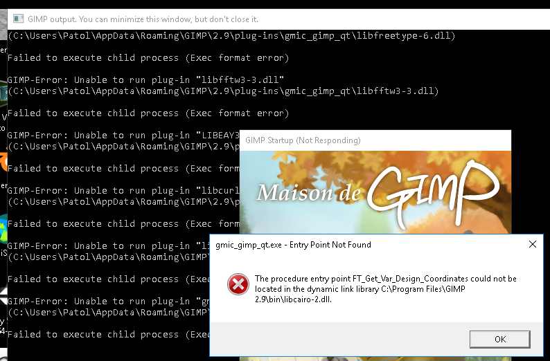

Hello, I have this error at gimp 2.9.6 x64 startup. It is build from www.gimp.org.
I' ve also tried build from partha, but i have different errors there. Can someone help please?

I know what the problem is but AFAIK it has been fixed with the latest gmic_gimp. If you have a clean installation.
Go to this thread where you will find a replacement libcairo file
http://gimpchat.com/viewtopic.php?f=28&t=15844

With my builds, please DO NOT install G'MIC from somewhere else. It's already built in.
Your errors are a results of DLLs being dumped into the GIMP plugin folder. I have no clue why you have them there.

Right, so replacing libcairo fixed that error, but gimp still doesn't like my gmic installation. I have tried putting gmic in various places inside and outside of gimp installation (always in separate folder), tried that with zipped version and with installer, I always have those 'unable to run plugin' errors. The Gimp version I'm using now is the one from www.gimp.org, not from Partha. Before I'll try another builds I'd rather use all my options, I am a bit afraid of making even bigger mess after installing another Gimp build over what I have here.
OK, I am running in a Win10 VM so easy to get a clean install. Fortunately Gimp keeps everything well contained so uninstalling Gimp.x.x then deleting the Gimp 2.9 profile in C:\Users\yourname\appdata\ roaming should clean things up.
Using the gimp.org Gimp 2.9.6 and replacing libcairo does get gmic_gimp working. As you correctly say, still a load of error messages about the gmic dll's.
I think you will have to accept these until a specific Windows gmic_gimp for Gimp 2.9 is released.

I did that Pat, did not work.
What did work was getting 'GIMP 2.9.6 64-bit Standard Edition portable' from partha.com. I played a bit with tools and gmic, and all is fine, no errors. So... thanks Partha, and thank all you guys for help :)
