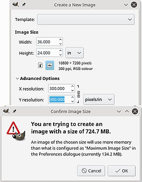

First the PDF, which might contain vector objects incl text which can be scaled to any size. Equally might contain an embedded bitmap which has an original pixels-per-inch (ppi). Low resolution original then scaling that up will degrade the line drawing in Gimp.
Next, Gimp will by default use 100 ppi when importing a PDF. It is up to you to set the ppi value in the import dialogue. ***Warning*** a 24" x 36" image @ 300 ppi is seriously large (see screenshot). A poster-size image rarely needs printing at a photographic quality 300 ppi. Depending on viewing distance, a rough guide is ppi = 1/((distance-in-inches x 0.000291) / 2) which for about 6 foot is 95 ppi.
What you need to do is ***ask the printing company*** for their requirements. They want a monster image like a hole-in-the-head.
FWIW, my advice, import the PDF with say, 150 ppi. It will still be a large size in memory maybe 500-600 MB) but not unmanageable. Save in Gimp xcf format. Save frequently, careful when saving, make sure the save procedure completes or you might lose it. Lots of solid colour compresses well so a final export as png and the file will be much smaller. Need a PDF for the printing company, very popular these days. Open your png file, export as a PDF.

Thanks for the replies!
If it's printed, it will be at 24"x36", but since it's an architectural elevation, the lines are heavy and there's no need for 300 dpi (probably half that, or 200). if I scale it up to 200, then look at it on the screen at 100%, it starts to blur when I scroll in close.
