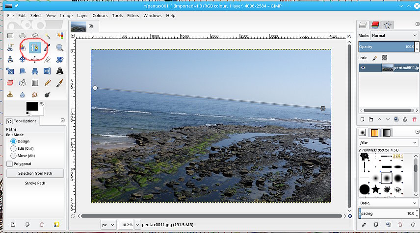

The standard way is the Rotate tool in 'Corrective (Backward)' mode, line the grid up with the horizon, click rotate, and the image is rotated accordingly.
However, to draw a 'line' you need a script. One attached 'auto-rotate.scm' **unzip** it pop it into your Gimp profile scripts folder
Windows C:\Users\"yourname"\.gimp-2.8\scripts
or Linux ~.gimp-2.8/scripts
Usage: Draw a **path** along the horizon, then apply the script, Layer -> Auto-Rotate

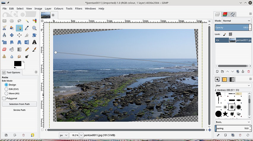

Thank you.
That works a treat - once i worked out how to get a usable path.

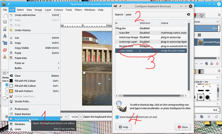

Most 'extra' Gimp plugins and scripts can be assigned a shortcut key. Problem is there are not many keys that are **not** assigned.
The best list of Gimp shortcuts I know is here:
http://clownfishcafe.blogspot.co.uk/p/gimp-28-shortcuts.html and gives unassigned keys G J V W Y 6 7 8
The Gimp docs for shortcuts is https://docs.gimp.org/en/gimp-concepts-shortcuts.html which leaves a bit to be desired.
Check the screenshot:
1. Edit -> Keyboard Shortcuts to open the editor.
2. Type in a search pattern, say auto
3. You will find that Autorotate is marked 'disabled' click on that and type in (say) j
4. To keep between sessions tick the 'Save....on exit' box
Now after you have drawn your path, hit the j key and the script will activate.

Thank you again.
I did look in the keyboard short cut but didn't find auto-rotate, and i completely didn't notice that there was a search option.
