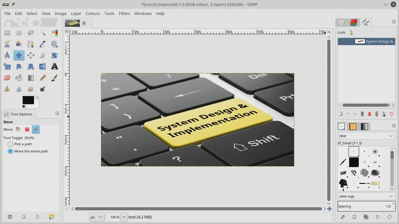

As well as all the other great advice you have been receiving.
When it comes to replacing the text with the perspective deform tool, use Text-to-Path and deform the path (text outline). That way, you will eventually get a 'crisper' result for the text.
A short video 4 mins as a demo. https://youtu.be/ghiYM35DKGs quick so do not blink
