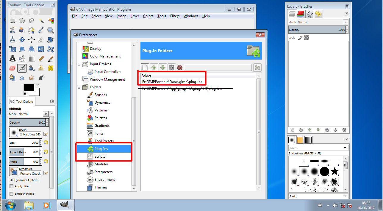

Determine the location of the default scripts / plug-ins folders in the Gimp Preferences dialogue.
In Gimp Edit -> Preferences -> Folders then the scripts or plug-ins entries.
The plugins entry is shown in the attached screenshot.

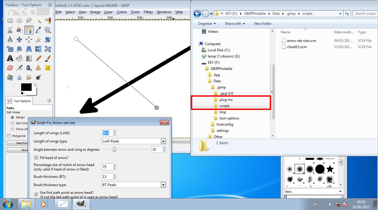

On your ***memory stick*** in the gimp installation, ***make two new folders***
GIMPPortable\Data\.gimp\plug-ins (note the '-') and GIMPPortable\Data\.gimp\scripts.
The obvious: scripts - something.scm go in scripts see: attached screenshot.
For plugins: something.py go in plug-ins
For compiled plugins, something.exe / something.dll go in the same place but make sure you use **32 bit compiled** plugins. This portable Gimp is a 32 bit Windows application.
