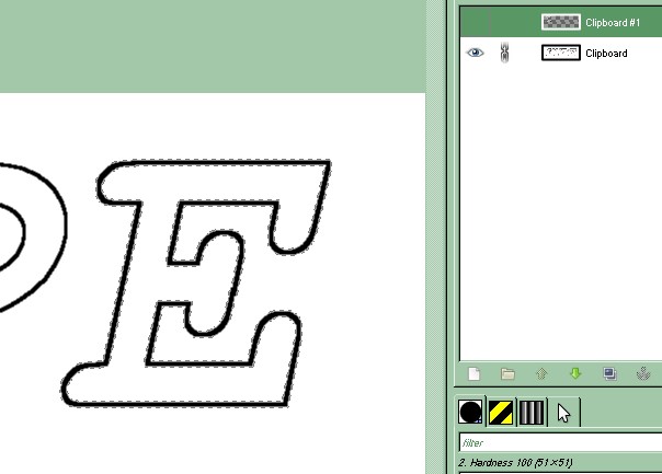

3. Paste that as a new layer Edit -> Paste As -> New Layer http://i.imgur.com/f5OWFoY.jpg It might have a border of background coloured pixels, which might need extra processing.
4. When it comes to filling in the selected out line with bucket fill, make sure 'fill whole selection' is enabled. http://i.imgur.com/xOriccU.jpg but an alternative is just paint over with a brush.

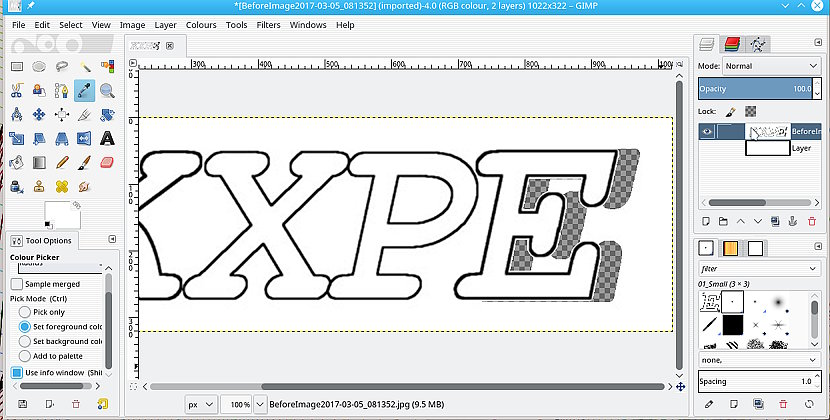

Thanks for the detailed reply. The grey area of the selected item was left after I used cut to remove the figure that I wanted to move. Your procedure using copy instead of cut works for me up to step 4, but then I cannot find a way to remove the original figure that I have copied. Paint and bucket fill have no affect, and when I move the pointer to the image it shows a little circle with a backslash to indicate that those functions are not allowed. 'fill whole selection' is enabled.

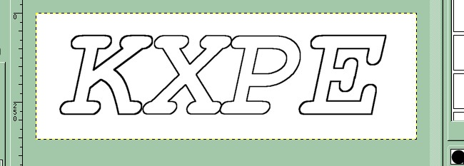

I am attaching two screen images. One shows the original image that I need to change so the letter E will be evenly spaced with the rest of the letters. (I am trying to create a logo for a community radio station.) The other image shows the letter E after it has been copied and I cannot find a way to remove it at the original location.

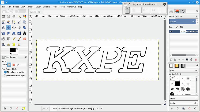

Always better with an actual image to work on as there are several ways you can do this.
Still using fuzzy select
Select the outline - and grow by one or two pixels
Change the select mode to addition - click in the middle to add the center of the letter.
Cut the selection then de-select all Select -> None
Paste the selection back in Edit -> Paste
That gives a floating selection layer. Use the move tool, click in the canvas, use the keyboard arrow keys to move.
When finished Anchor the floating layer. Layer -> Anchor layer.
Hope you can watch that as a video. 1 minute 20 seconds, so do not blink
https://youtu.be/TlnP2T1qmZ0

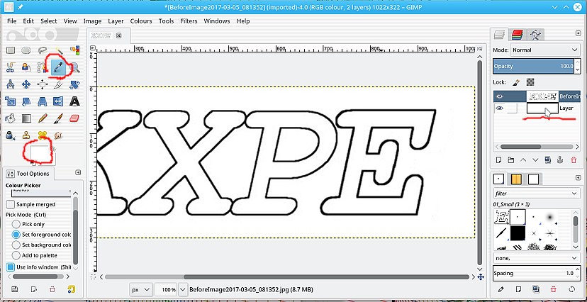

It is all to do with transparency - in Gimp the term is alpha channel. A jpg image does not support transparency so when you open a jpg in Gimp, on its own, there will be no alpha channel until you add one.
Depends on your overall project but looks like somewhere you have added transparency.
Assuming the logo has been cut out of some other image for use in your project.
Going back a post & easier than the video
Fuzzy select inside the E
Grow the selection by a suitable amount to include the border, looks like it should about 6 to 8 pix
Cut, kill the selection, paste in, move into position.
It might look like the first attachment.
You can remove the alpha channel Layer -> Transparency -> Remove alpha channel but there is no guarantee that the 'white' background in the image is 100% white. If it is 100% white just lose the alpha channel.
Otherwise add a layer under the text and fill that layer with the colour picked FG color, which you have already know about. second attachment.
