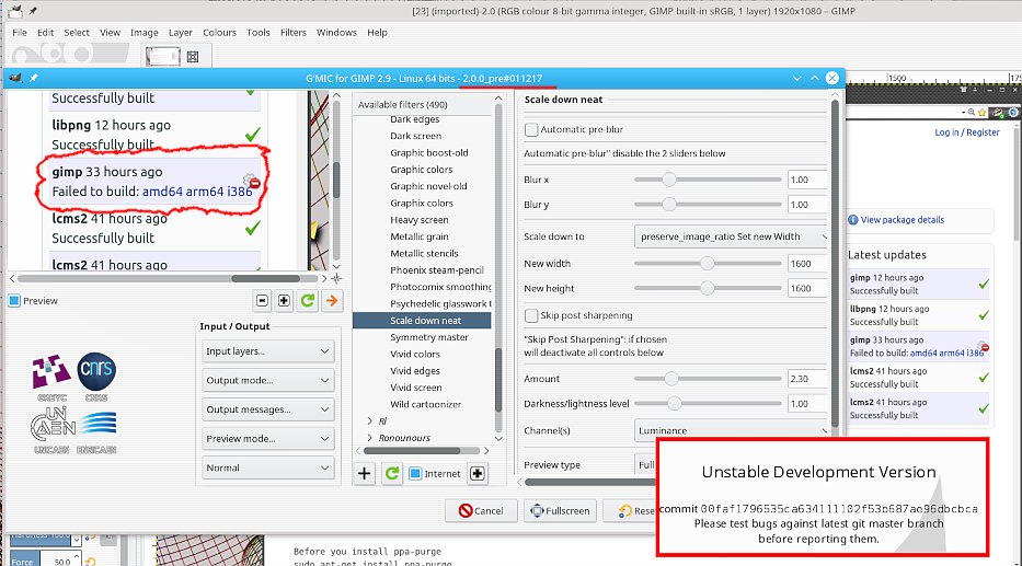

There have been a number of 'fails' in the last few days, both Gimp and dependencies. Keep checking here until there is a good build.
https://launchpad.net/~otto-kesselgulasch/+archive/ubuntu/gimp-edge
I compile a 'portable' an appimage from there and also a gmic compiled against the gimp 2.9.5 code and Gimp 2.9.5 / gmic-2 from about 15th Jan works ok. screenshopt attached.

A bit more digging, The aim, to update my appimage.
I use Kubuntu 16.04 (Xenial) and the latest Gimp 2.9.5 build failed for that, but not for Yakkety. So I my installation has not updated and I can not compare like-with-like.
Looking at the Gmic pre-release downloads, I always go for the zips rather than a deb package, and apart from the regular gimp_gmicXX.zip there is a gmic_gimp_yakkety64.zip , very small 2.1k, only contains a readme file. Obviously not the version you are using.
However, the last issue, 12 Jan, gimp_gmic64.zip unpacks to gmic-gimp2 (6.9M) and that does work here in Kubuntu 16.04
Rather than gmic, it could be the latest Gimp 2.9.5 Back to wait a couple of days for a new update.

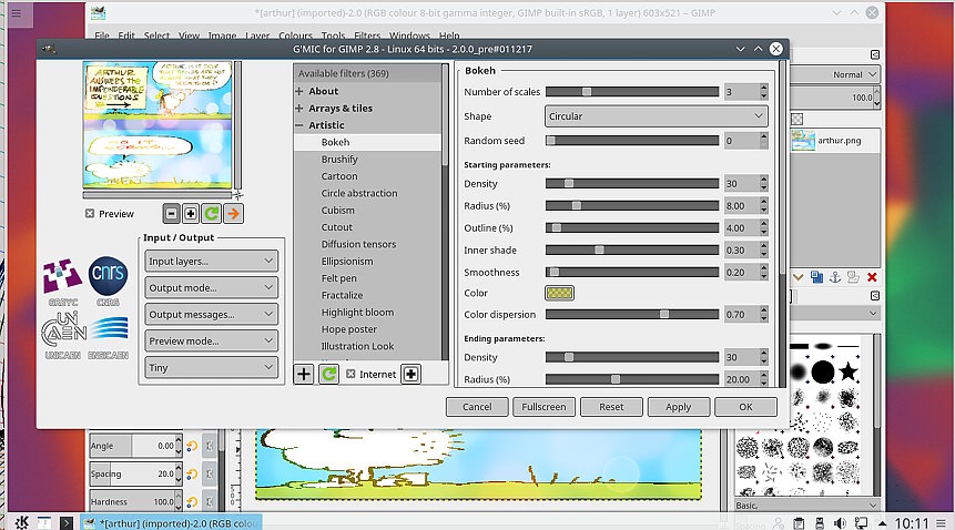

It works.
I try to build "downgrades" to https://git.gnome.org/browse/gimp/commit/?id=00faf1796535ca634111102f53b687ae96dbcbca, and I will wait for a solution of the issues before I publish recent Gimp 2.9.5 versions.
Cheers
