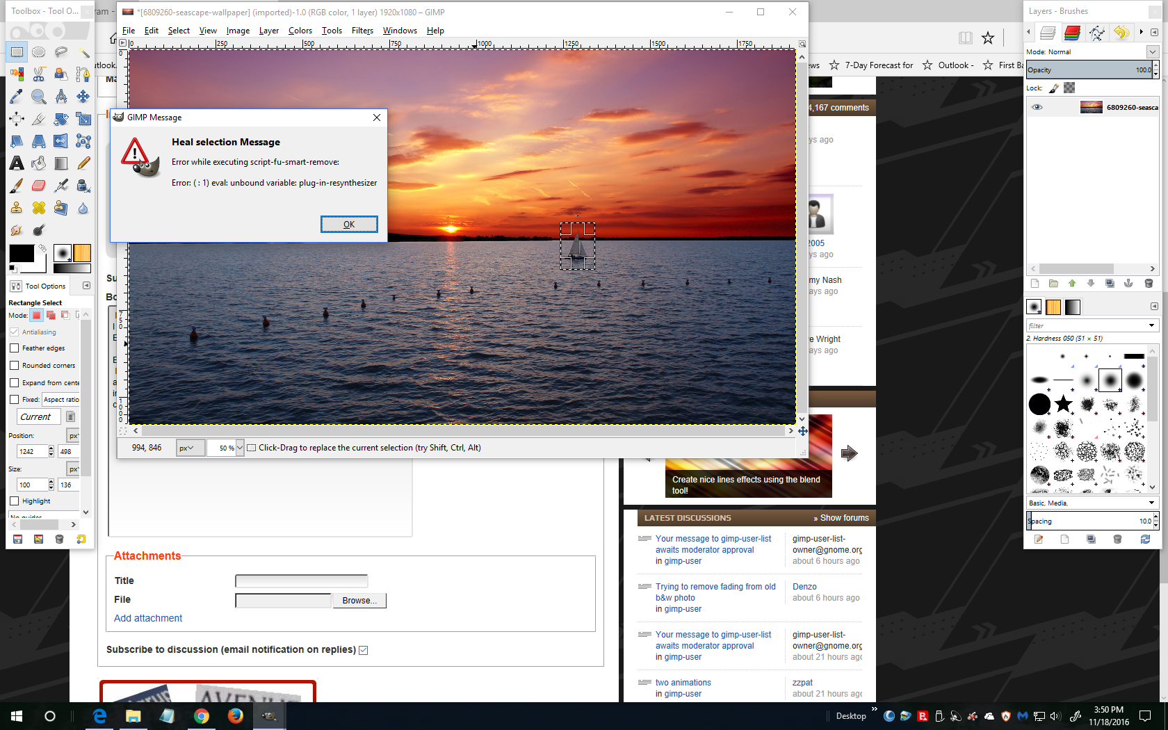

I have Windows 10. I followed a tutorial, but the heal filter doesn't work. I get the error message:
Error while executing script-fu-smart-remove:
Error: ( : 1) eval: unbound variable: plug-in-resynthesizer I put resynth.exe in c:/users/ed/Gimp2.8/plugins, and I put: resynth_pattern_fill.scm, smart-enlarge.scm, and smart-emove.scm in the scripts folder: c:/users/ed/gimp2,8/scripts

This is not a standard directory for GIMP plug-ins - are you sure that this is one that you have set up on your system, and do you know how to verify that in GIMP's preferences?

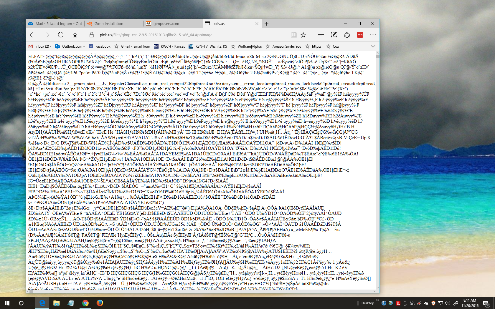

Thanks Rich I appreciate the help. I went to Parta.com, but the link was, I think maybe source code. I am not a power user or anything. I just can't afford Photoshop. could you post a link to the correct version of Gimp that is an installation package for Windows?
No, your screenshot is of pixls.us and a portable linux 'appimage' nothing to do with Windows.
You need this site www.partha.com
and this installer. 64 bit windows only, If you use 32 bit Windows, look at the video link I posted.
http://www.partha.com/downloads/Gimp-2.8.14-64bit.exe

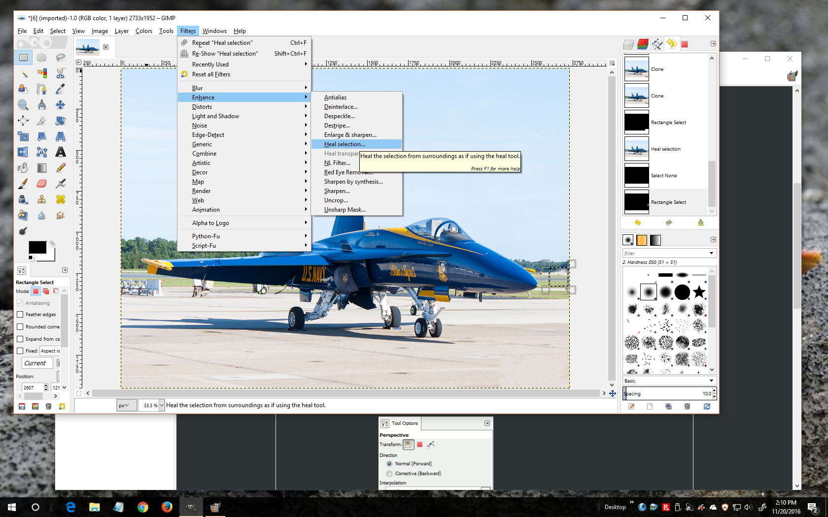

Just a note:I installed Partha's file and the Heal selection works great now! Thanks everyone.
