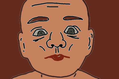

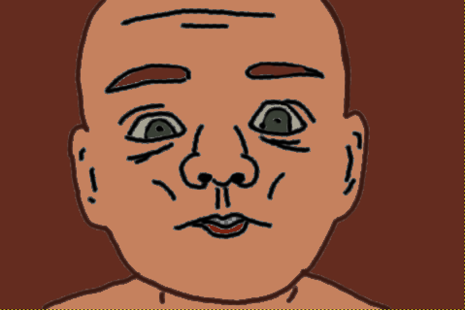

I'm adding more here as I am about to leave and will not be able to post photos for a while:
To show you how it looks when I'm drawing in Gimp, I've attached some images:
1. The first attachment is of the image taken as a screenshot, cropped in Paint and saved as a png. No halo issues.
2. The second attachment is of the image exported from Gimp as a jpg. Halo issues. I also saved it as a png to see if this would make a difference. It didn't.
3. Fill issues can be seen:
a. around the edges of the eyebrows - I actually used the paint brush to add color near the edges.
b. eyes - same as eyebrows
c. lower lip - same as with the eyebrows and eyes. I will have to use the paint brush to fill in the rest of the lower lip.
d. upper lip - cannot use fill tool to add color. When I try to do this the whole mouth, including the outline fills in the with color. (see third attachment) I will have to used the paint brush to add color.

The "halo" is "anti-aliasing" pixels that are not painted because they have an intermediate color, and the fill tool will either completely paint a pixel, or not paint it at all. For a complete explanation, and the good methods, see Proper subject extraction, background removal, and background painting

When filling colors, at the top of the Tool options dialog for the paint tool, set the paint tool "Mode" to "Behind", to make it "fill the transparency" and leave the rest untouched. If you are using the bucket-fill set the Threshold value to the highest value that doesn't cause a spill (about 150 for black lines on transparency).
Comparison of the methods (I believe you are using "Normal" mode with a low threshold): http://imgur.com/hSwJoX0
