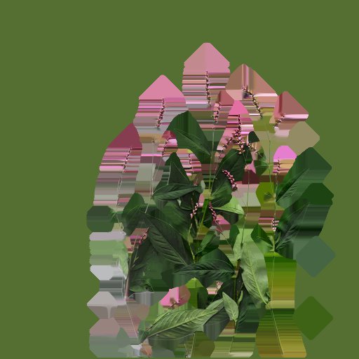

Hi :)
Does anyone know wether it's possible to spread the pixels colors considering the normal vector of the selection curve ?
I post an image that would be the approximate result of what i imagine.
thanks for your answers :)
regards.

oh so as a basic function, or event with a plugin, this thingie do not exist ? That's what i was wondering, as it's something that can be done in PS. OK for the script. Unfortunately i'm absolutely not able to code a plugin for gimp, not knowing how it's done and lacking of knowledge on the 'how to'. Nevertheless, koko, i think you principle works from the center of the picture. A selection on the upper rightmost half of the pic would not give the expected result. Your idea would look like the zoom blur wich is done from the image center as blur center ( i think ). But it should work with taking each selection island center ant iterate zoom blur through them....

I'm not very good with scheme, so please don't be too harsh with me, but I've made a dirty script to show you (and too see it myself, too :D) how that would work. The script is just a draft (it doesn't check errors, always uses the first layer, there are magic numbers, ...), but I attach two pictures that show the before and after (selecting a rectangle in the middle). It's not perfect, but maybe it could help you.
