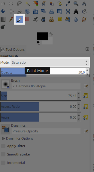

There are many ways to do this. Here are two easy ones:
* Before doing the saturation make a selection that only has the parts selected that you want to saturate. Or use a quick mask so make a semi-transparent selection with a gray colored brush on the chin. then the saturation will not have the full effect.
* or: After the saturation of the whole picture, you could use a black brush with the "Saturation" mode and lowered opacity. Painting over the chin will slighty desaturate it (see picture).
