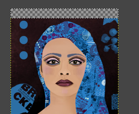

I understand both trim and the rectangle tool but when i try to cut or trim the top off an image, it leaves an alpha layer visible. I want to have a clean cut that will cut the top of the image off clean. Can anyone help me? Thanks, I have been trying to do this for 2 years. (I do not want to leave a transparent background)
Jude

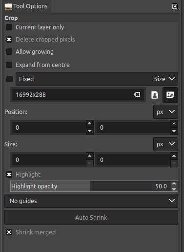

121
trim image
I'm not sure what the interpolation type has to do with the Crop tool.
Having selected the area that you want to keep the Tool Options should look like the attached image. This shows the two setting =s mentioned. If you are using GIMP in multi-window mode you may have to press the Tab key to see the toolbox.

2021-01-14 22:22:11 UTC (about 3 years ago)
121
trim image
Just realised what the problem might be. If you go to "Windows/Dockable Dialogues" is "Tool Options" selected? If not try selecting it.
2021-01-15 07:40:07 UTC (about 3 years ago)
6
trim image
I read that checking the nohal would prevent the pixels from moving around, but maybe I misunderstood the article. Thank you for all the additional information and image of the tool options, I will follow your instructions and let you know when I am successful. Jude
2021-01-15 08:47:54 UTC (about 3 years ago)
6
trim image
There we go! That did it. A million thanks! Jude
