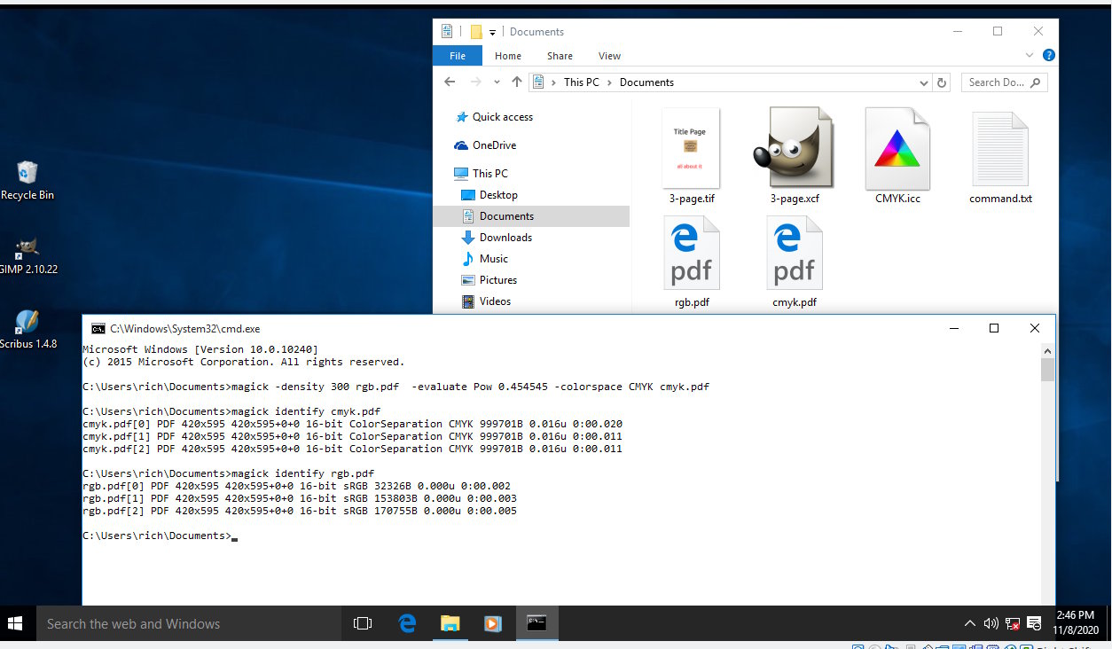

2020-11-08 15:06:05 UTC (almost 5 years ago)
40
HELP! Converting RGB to CMYK
Would IM be able to convert RGB PDF to CMYK PDF perhaps?
quote..Sadly there is at least one photo image on every page,..unquote
No way round that with Gimp, you have to merge the text with the image. Then text is no longer text.
rgb PDF to cmyk PDF using IM
Possible with the same proviso as before. Any text is converted to a graphic which also makes large PDF files.
The command is (and I hope that this time, this dumb, useless forum does not scramble it)
magick -density 300 rgb.pdf -evaluate Pow 0.454545 -colorspace CMYK cmyk.pdf
and if you find that the colours are too light
magick -density 300 rgb.pdf -evaluate Pow 2.2 -colorspace CMYK cmyk.pdf
The density commands are there otherwise IM will use 100 ppi (same as Gimp default PDF import) and you get a low quality fuzzy PDF.
