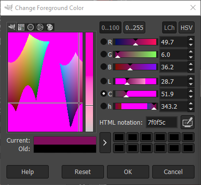

Any idea what causes this issue? I've tried reformatting to fix this and it persists.
Dying video card is my suspicion, because this was not an issue just the other week when i last used the program.
2019-05-23 08:48:54 UTC (about 6 years ago)
Ussues with color selector
Can not be definitive, but I think that color management is the cause.
Go into Edit -> Preferences -> Color Management and first click on "Reset Color Management" then set Image display mode to "No color management" Ok that and restart Gimp.
Open your image, Check in Image -> Color Management and if enabled untick.

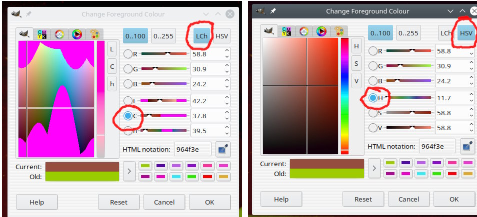

Keep coming back to this because I have seen it before and could not remember.
It is the select color mode that affects the display.
With LCH ( lightness / chroma / hue ) and C (chroma) active gives that display
Change to one of the RGB channels or better HSV (hue / saturation / value ) and H (hue) gives a more usual display.
