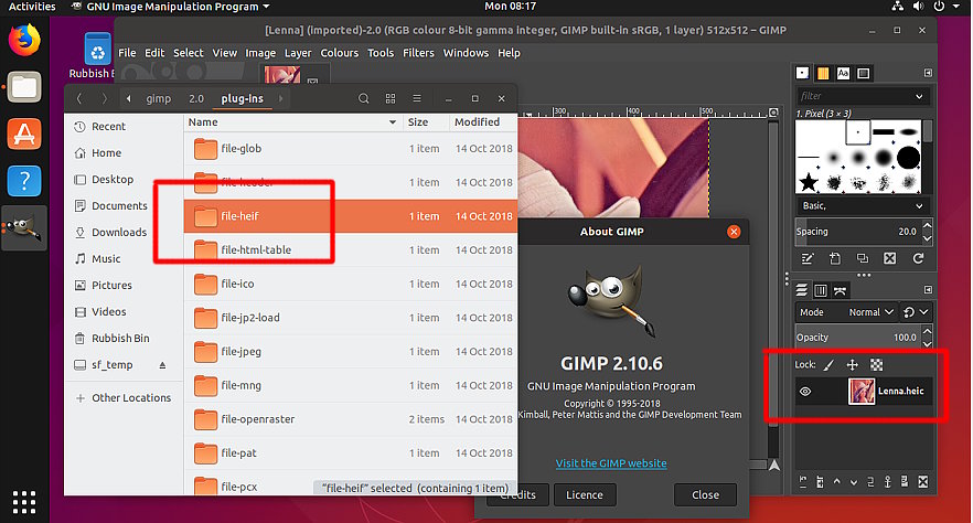

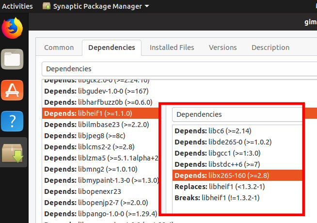

As with much of Gimp it depends. Gimp version and distro.
An Ubuntu 18.10 (VM) and all works as expected. The gimp package contains the file-heif plugin and pulls in libheif as a dependency, which in turn pulls in libx265..and so on. see screenshots.
