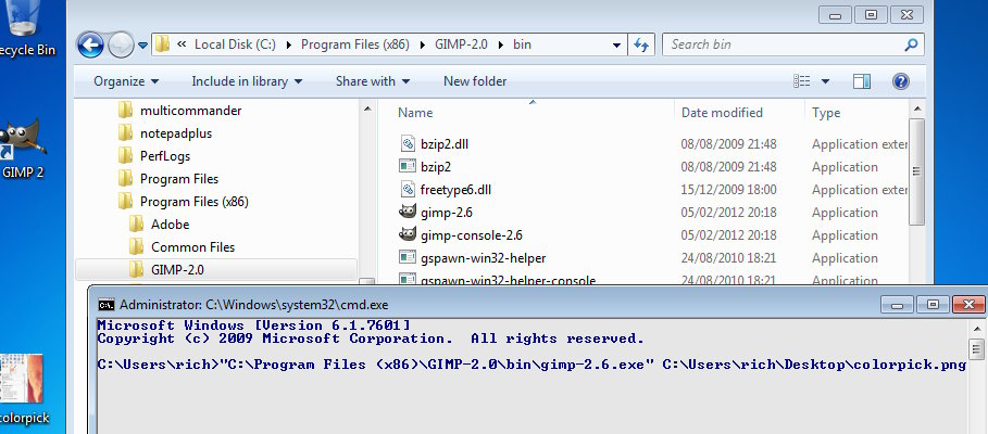

Do you have Gimp installed? Are you really using Gimp 2.6? Why are you using Gimp 2.6?
The default installation directory changed from Gimp 2.6 ..\GIMP-2.0\.. to ...\GIMP 2\... for Gimp 2.8 or 10
Do not know about your VB script but from command line
Gimp 2.6 would be (assuming 32 bit Gimp in 64 bit Windows)
"C:\Program Files (x86)\GIMP-2.0\bin\gimp-2.6.exe" path-to\image.ext

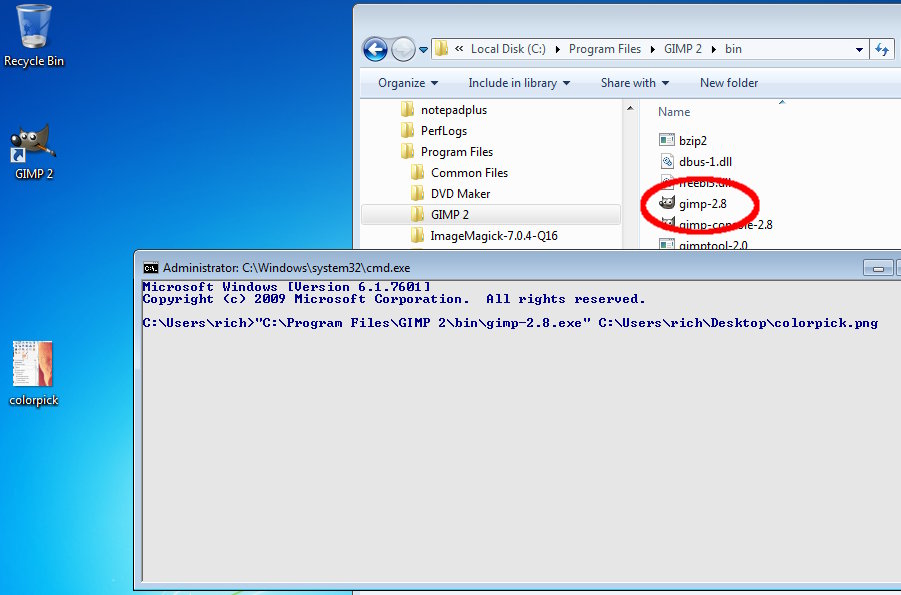

For Gimp 2.8/10
"C:\Program Files\GIMP 2\bin\gimp-2.8.exe" path-to\image.ext (or gimp-2.10 as appropriate)
see attached screenshots
