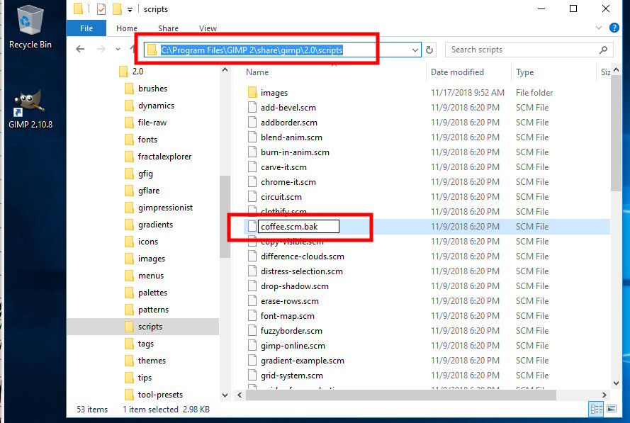

Hello, Gimp world,
So I have come to a point where I know my workflow and certain filter I in no way need...
Is there a way to remove certain filters which are built into gimp?
I tried looking through the files but with no success. (I tried to locate the filter 'Coffee stain', as a test.)
Any help and guidance would be very welcome.
Windows 10 - Gimp 2.10.8
Thx

The particular filter that you mention is provided by ...\gimp\share\2.0\scripts\coffee.scm (where you need to put the appropriate path to replace the ...). Deleting this file will remove the filter - although it will reappear next time you reinstall GIMP.
The question is why bother? The script file itself is only 3 KB, so doesn't take much disk space. Why not just ignore it if you don't want to use it?

No need to delete anything, renaming the script so it does end in .scm stops Gimp loading it and it is still there if needed in the future.
A better way is investigate using a resources manager where scripts can be loaded as required. Would need a bit of work to move stock scripts out into a User folder but is possible.
A resources manager? - one here - addonCollectionManager-3.0.py - http://sourceforge.net/projects/gimp-tools/files/scripts/ about 40 down the list.

You could just write a batch file (.BAT) to rename or delete the scripts (Script-Fu or Python) that you don't want. Add extra files to it when you find another script that you don't want. Then simply run the batch file whenever you update GIMP and the scripts have reappeared.
