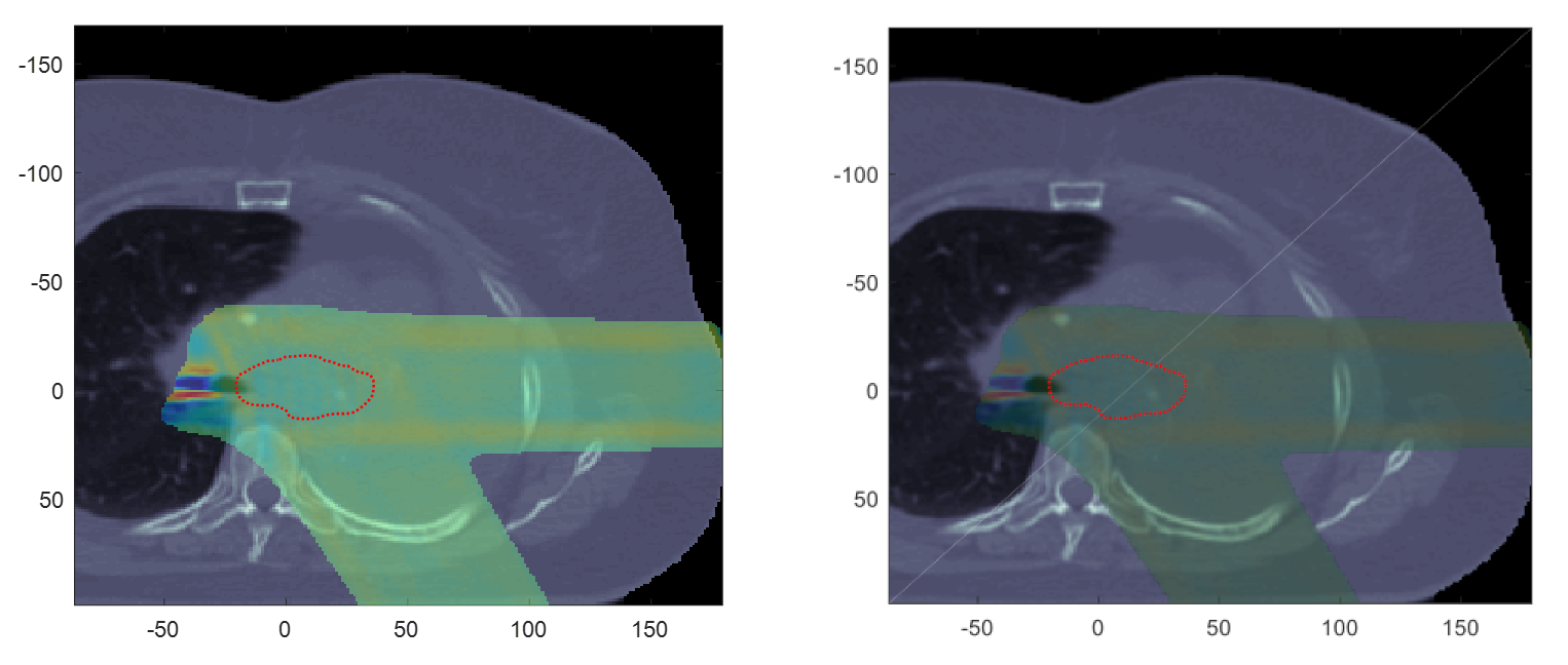

Hello All,
I had a wired thing that when I imported the PDF picture into GIMP, the color is different. See the attached picture. You can find the colorwash becomes darker. I didn't adjust anything. Do you know how to deal with it?
Thanks.

Hello All,
Thanks.
Probably the PDF has been made ready for printing in the CMYK color space. Since GIMP works in the RGB color space, color differences may occur during conversion.
