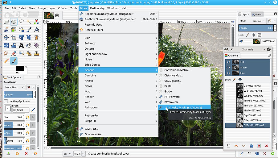

I am attempting to update the Saul Goode version of the Create Luminosity Masks Script-Fu script, sg-luminosity-masks. It works fine in GIMP 2.8, but I have just updated to GIMP 2.9.8 to take advantage of the automatic link to darktable for importing RAW images.
When I first ran the script it ended with an error based on the use of deprecated functions in the script. I replaced the function names with the newer versions and the script starts to work but I eventually get the following error message:
----snip----
You do not say which operating system, I am assuming not Windows.
The original file raises deprecated procedure warnings but they are just warnings.
Start Gimp up with the switch --pdb-compat-mode=on and the warnings are hidden. The script works as usual
screenshot example: Kubuntu 16.04 Gimp 2.9.9 original luminosity script Image imported using nufraw 16 bit

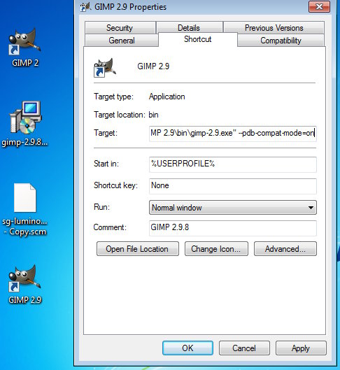

----snip----
Just twigged the Gimp 2.9.8 bit. It is most probably Windows
Add the switch --pdb-compat-mode=on **after** the quotes in the windows launcher. Blame Windoze and their use of spaces in paths. Note the space after the quote.
"C:\Program Files\Gimp 2.9\bin\gimp-2.9.exe" --pdb-compat-mode=on

Still advise adding --pdb-compat-mode=on to the startup.

Thanks for all of your help Rich! I realized after posting that the 6 times I tried to run the script all worked. I'l add the switch to my shortcut.
Cheers!
