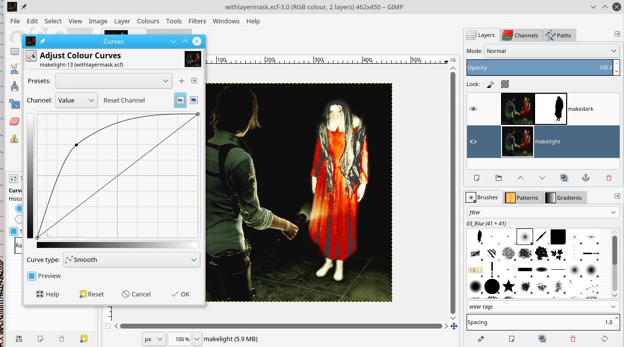

I recommend starting from scratch.
Take your original image and duplicate it.
Add a (white) layer mask to the top layer. If you paint in that in black it shows the bottom layer. see: https://docs.gimp.org/en/gimp-layer-mask-add.html
Now you can adjust the two layers, top one darker, bottom one lighter. The screenshot shows the bottom layer.
Attached un-edited .xcf with layer mask.

That worked! Thanks so much for your help! :)
