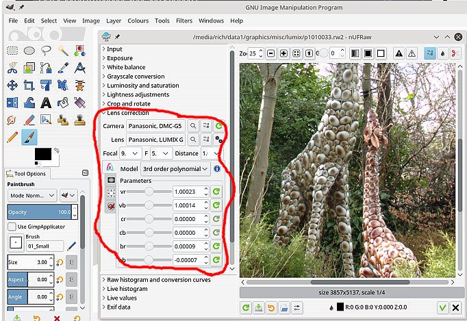

AFAIK the only use for lensfun with Gimp is when you need to import a digital-camera RAW image with a plugin.
OpenSuse 42.3 looks like still using Gimp 2.8.18 The only plugin I can think of will be ufRAW, probably in the Opensuse repo to install. It is old, there is a updated version nufraw which you will probably have to compile yourself. The screenshot show that opening an image and the lens adjustments.
