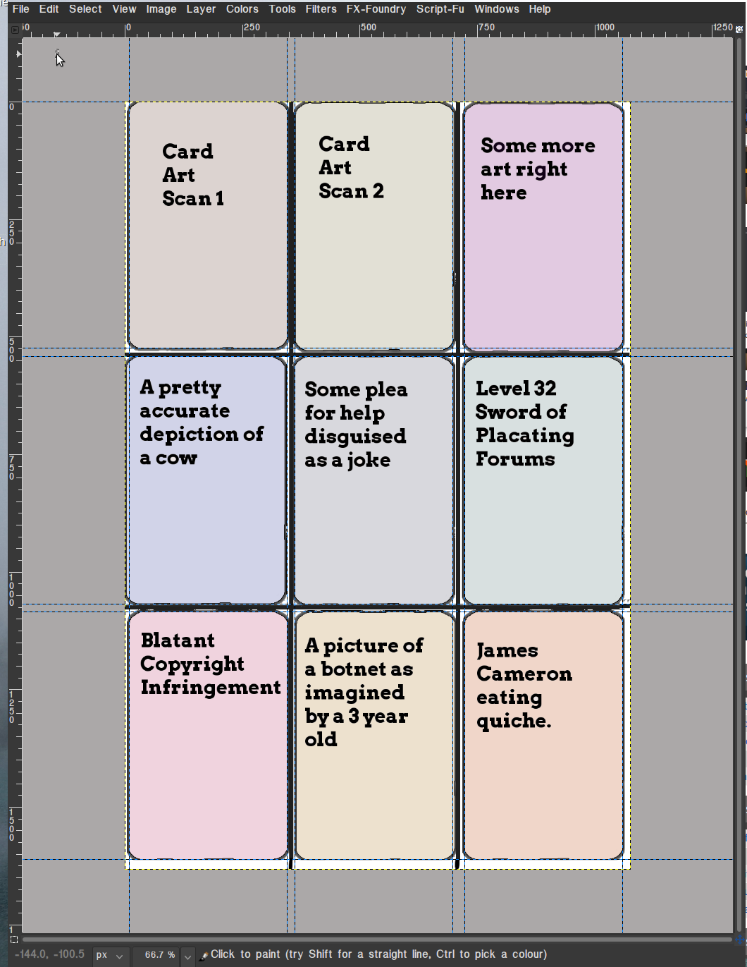

Hello gimp friends,
While I am not new to Gimp (I think I first downloaded it in 2002 or something?!), I am new to not doing things like an idiot.
I am scanning card art for a board game I am making, and I simply want to eliminate noise from the guillotine tool's output. There is a popular scan separator that doesn't quite do what I want, you have to go in and cut out all the negative space to make it true white.
I use guides for correcting crooked scans and eliminating space. I know there must be a simple Guillotine with Threshold or eliminate size /= X sort of script out there somewhere, I just can't seem to find it. Right now, guillotine creates dozens of tiny images of no value and then 9 images I want.
Could someone point me in the right direction? You are welcome to tell me that I am doing this wrong as well and that there are better solutions. I like learning! :)

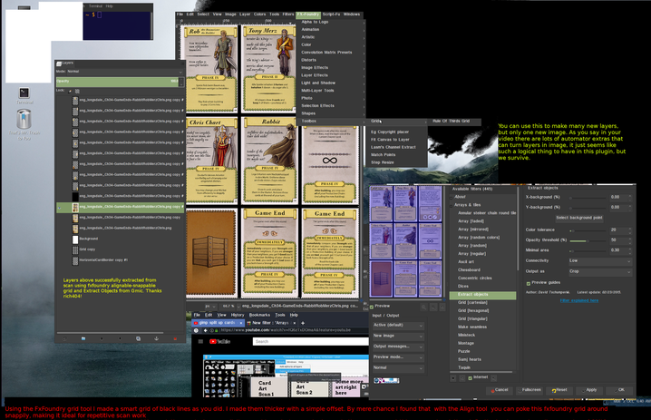

Rich, thank you for the tutorial again. I combined the extract objects with the fxfoundry rule of thirds grid, which automatically divides into N rectangles based on image information, then thickened it with an offset. The moral of the story is that border space between scans is important. I accidentally clicked the align tool and you can snap gridlines around based on image data, so a bonus solution there for someone like me doing hundreds of error prone scans!
Thank you for your help. Attached victory shot.
