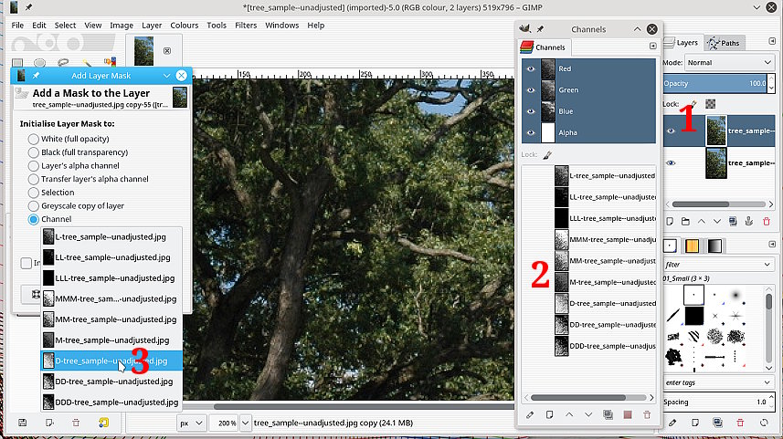

Run that and it makes a lot of entries in the channels dialogue. One way of using is, channel to selection, then adjust the selection - brightness, contrast, ....
Another way is use a layer mask. So using your image. (luminosity01)
1. Duplicate it
2. Apply the luminosity mask script
3. Add a mask to that layer, selecting a suitable channel. Black is transparent, White is opaque. To keep the sky and lighter foliage, and adjust the dark vegetation, 'D' might be a suitable choice.

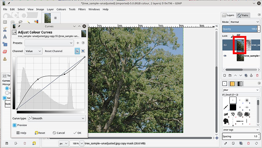

Working on the duplicated image (not the layer mask), adjust using whatever tool you like, color curves is a good choice. (luminosity02)
