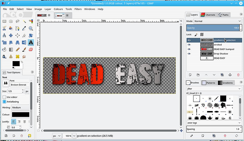

Not exact but maybe something like this
1. Create your text layer, use the on-canvas option to set the colors.
2. Text to Path. Stroke the path (1 pix ) on a new layer
2. Maybe optional but I bump-mapped the text using itself as the map.
3. On the text layer, Drop shadow using Filters -> Light and Shadow -> Drop Shadow (about 75% opacity)
4. (Text) Path to selection and apply a black to transparent gradient bi-linear shape, start in the center and out to the edge.
examples attached
examples attached

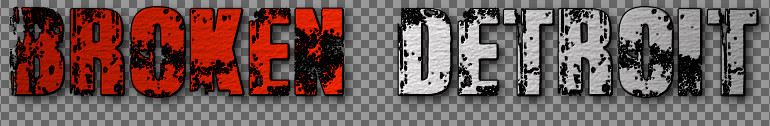

You need more texture? Try filling a selection of the text with a pattern as an overlay then adding to the text in a layer mode (try value mode).
Then again maybe some bump mapping, this time the overlay layer
Attached a correct example this time, a Gimp xcfgz with all the layers. Sorry for the last duplicated error.
There will be other ways but for a texture generally you need some bump mapping.

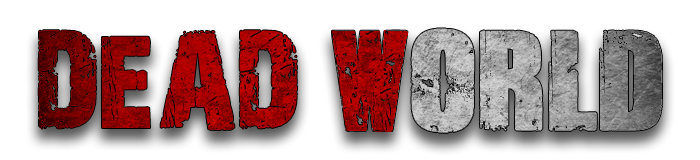

Thank you so much! Though i found a way to give it some rough texture and such after some trail and error this is how the W
looks i decided to make all the text red. Best Regards
