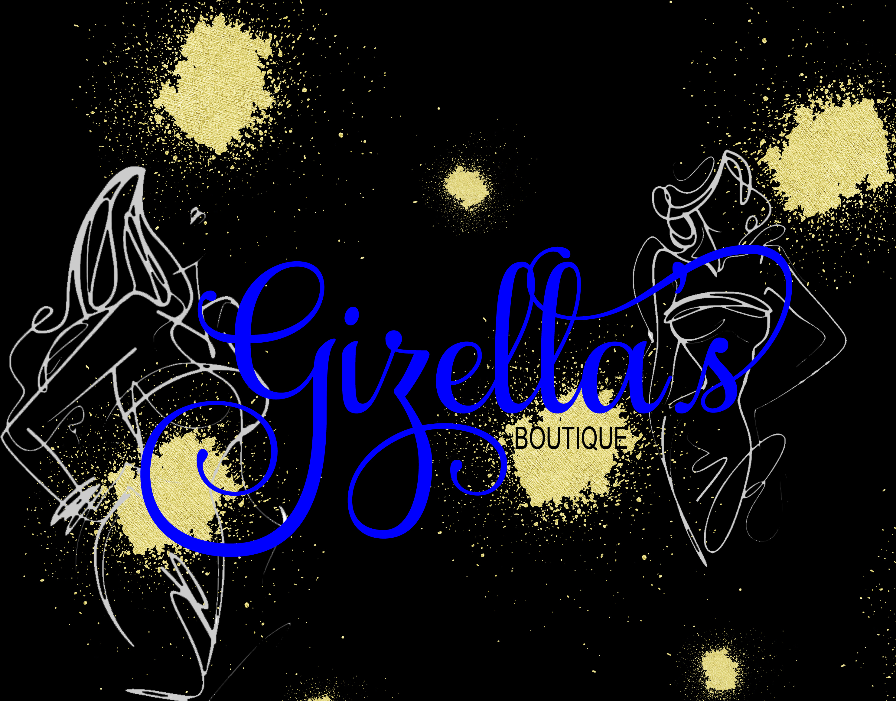

Can someone tell me if/how I can use Gimp to replace the goldish splotches with my own pattern? I've been able to get the pattern into Gimp. But can't figure out if I can replace the splotches and dots with it. Any input is greatly appreciated!!!

One way might be to use select by colour (shift-O) on the gold until you have all of it. You might need to deselect the human outline on the left. To do that,
(1) in tool options, with select-by-colour active, reduce the threshold probably to 1 or 2
(2) hold control down and click in that outline, on one of the whitish lines.
This may leave 1-pixel holes in the selection of the gold. That's OK, grow your selection by 1 pixel. select->grow.
Now feather the selection by 1 pixel (select->feather) to blur the edges slightly.
Now, if you have your patten as a layer in the image below the main part, edit->cut will make holes in the top layer and you'll see through to the pattern. If it just makes the gold solid background colour, undo, show the layers dock (control-l), right-click on the layer's name and "add alpha channel" which is gimp-jargon for "allow transparency on this layer". Then do the cut again.
An alternative is to use the bucket fill tool and fill with pattern. You can have the pattern open as anothe image and do edit->select all (control-a) and then edit->copy (control-c), and then go back to the main image and one of the patterns in the Tool Options dock for the bucket fill tool will be the clipboard.

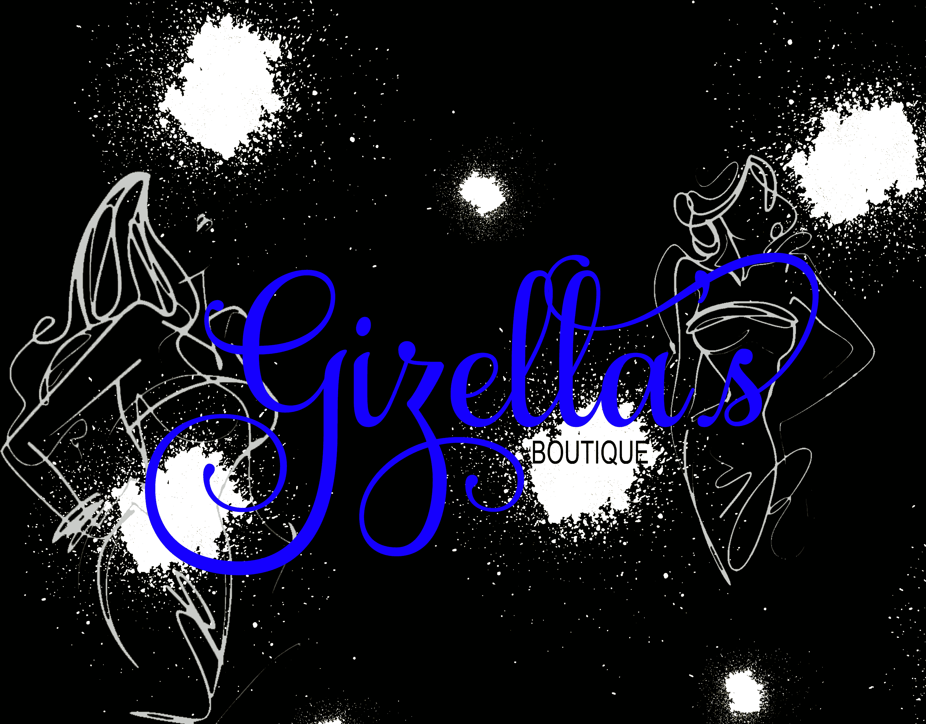

2016-11-19 13:29:20 UTC (almost 9 years ago)
Replace Gold Splotches
Sorry, totally misread the subject.
Same procedure using indexed mode, this time change all the gold-ish colours to the same basic colour, I used red.
Back to RGB mode, Add an alpha channel
Color select that colour red and cut.
That gives the attached. Put a new layer under that and fill with your pattern.

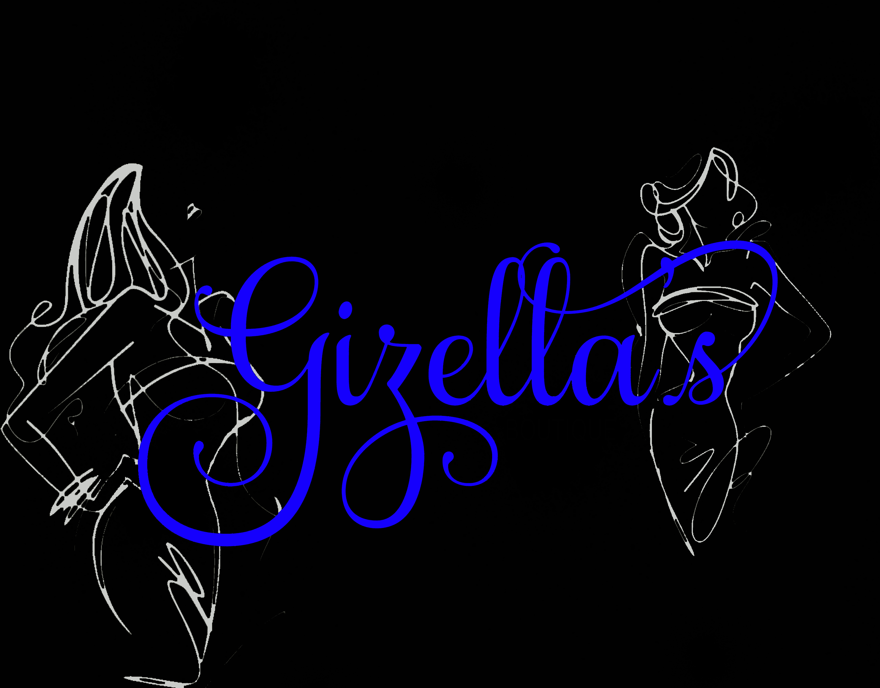

Just for grins I took a copy of the sample image that was uploaded and made the gold bits transparent. It was easy, because I selected everything /but/ the "gold" and then inverted the selection.
Using the Select By Color tool, click once to select all the black, then hold down the shift key to select the blue and etc.
There will be stray pixels that did not get selected, due to color variations produced by anti-aliasing. So, zoom WAY in and start selecting those strays with the same tool, holding the shift key down of course, until everything you want to keep is selected. That took me a minute or two.
Then do Select > Invert and viola, a precise selection of the "gold" only, to do with as ye will.
