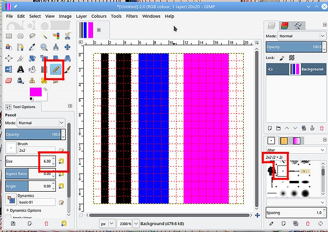

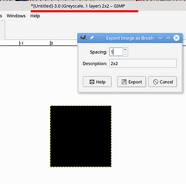

1. Make a 2x2 px grayscale .gbr brush. Grayscale so it will pick up the foreground colour. see screenshot:
2. As you said, use the pencil tool to avoid anti-aliasing.
3. Select the brush, set the size and colour. see screenshot
4. There are snags if using shift-click to draw straight lines. The origin and end of a line is center of pixel, which of course for an even number of pixels is off-center of the brush. In that case make a path, stroke the path with anti-aliasing turned off.
