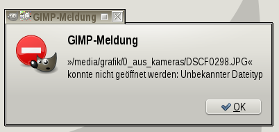

I just finished to install Kubuntu 14.04-5, the newest version of Kubuntu with Plasma 4. Now, I get the following error message when opening a picture in gimp. Identical behaviour with jpg. png, svg. Only xcf files are recognised. I install via the console, not via muon. The installation went properly through, without any error messages.
Any suggestions, how I can repair? Many thanks for any help.

All clear now. I just remembered a similar problem with another program could be solved by deleting the configuration file in /home. So I deleted the file .gimp-2.8, started Gimp, and the pictures can be opened again. I now have to find out, which configuration was responsable for this.

On 16/08/16 13:35, Arran wrote:
Hello
Typically you should have something like this in ~/.gimp-2.8/pluginrc:
(plug-in-def "/usr/lib/gimp/2.0/plug-ins/file-jpeg" 1468533087 (proc-def "file-jpeg-load" 1
"loads files in the JPEG file format" "loads files in the JPEG file format" "Spencer Kimball, Peter Mattis & others" "Spencer Kimball & Peter Mattis" "1995-2007"
"JPEG image"
0
(icon stock-id -1 "")
(load-proc
(extension "jpg,jpeg,jpe") (magic "6,string,JFIF,6,string,Exif") (mime-type "image/jpeg") (thumb-loader "file-jpeg-load-thumb"))
And similar things for loading and saving other image formats.
