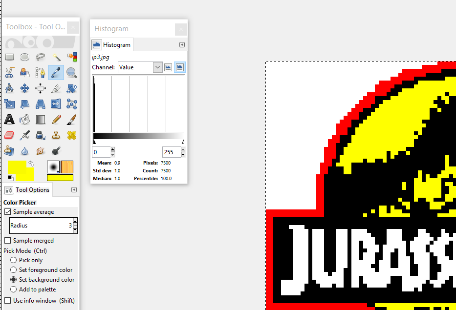

That doesn't work.
I attached a screenshot to see how that looks like

It works for me using the "Select by Color" tool - from your screen-shot you are using the "Color Picker Tool" - try "Select by Color"

You are right, my mistake.
It's working. Exactly what I neede. Thank you very much!
