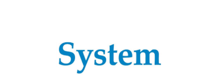

Thanks for your reply. I'm not really sure how to tell whether the words are really dithered or not. There are no sharp edges around them or the logo though that I'm trying to swap the colors on.
Attached is what I'm working on.
Attachments: * http://www.gimpusers.com/system/attachments/161/original/Image.png
Yes, the letters/logo are dithered. The edges are "fuzzy".
Since this is a very simple text-logo, if you know and can get access to the font used for the original, you could much more easily (and in higher quality and more quickly) recreate by using text in an image program of some sort -- actually probably better in a vector-based program (Inkscape, Illustrator, etc.) instead of a bit-map-based program (Gimp, Photoshop, etc.).

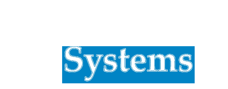

Thanks for finding out what font it is. I used the steps mentioned and that worked for the words, but there is a logo to the left that it didn't work for. Also now the word looks crappy, due to an outline.
Attachments: * http://www.gimpusers.com/system/attachments/162/original/Image2.png
In your sample image, I don't see a "logo to the left". Do you see it when you look at your PNG ?
I don't know why there is an outline in the word. That's not right at all unless that's what the font you used looks like (with an outline in it).
When you create the word, be sure your background is the color you want (I forget whether you want colored letters on white background or the opposite). And be sure you using the opposite color when creating the word. There is no "messing around" beyond that -- in regard to the word. It should be created at the size you want and then not messed with (which means that to create other sizes, you should retain access to your original source of the font). For best quality text, don't later enlarge or shrink, re-create at the needed size (this is where a properly constructed scalable font in a vector-based program is most helpful).

Thanks Jay and everyone else, I forgot to add the logo that's to the left in the image before posting. It is weird regarding the outline, I've seen our logo on our main website with a gray background and there is no outline around the letters. This seems to be turning into more work than I thought it would have been. I'll see if there is anyway I can get ahead of the original.
