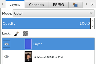

The maybe easiest way to do this is to create a new layer atop the Background layer. Fill it entirely with the color of your choice. Then set the lays more to "Color".

Method 1: Create a gradient from your darkest blue to your lightest blue, and use Colors/Map/Gradient map.
Method 2: Add a new layer above the grayscale one, bucket-fill it with your lightest blue, and set it to "multiply" mode.
