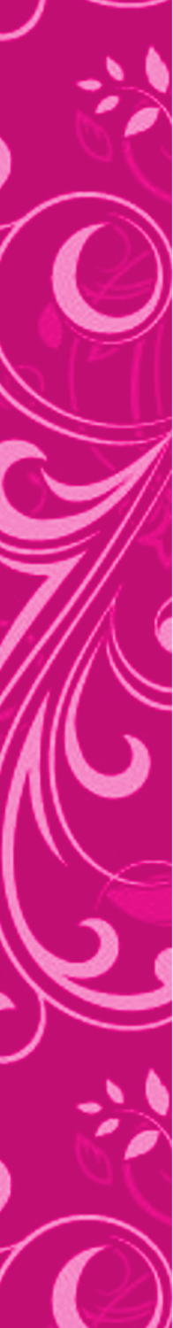

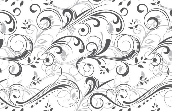

I am having trouble colorizing a greyscale image. I actually did manage to do it earlier but can't remember how I did it. See attached the greyscale original image and the colorized pink image that I had created earlier. I tried inverting and colorizing but I can't seem to find the right setting. I also tried to create a pink layer and change the blend mode to color.

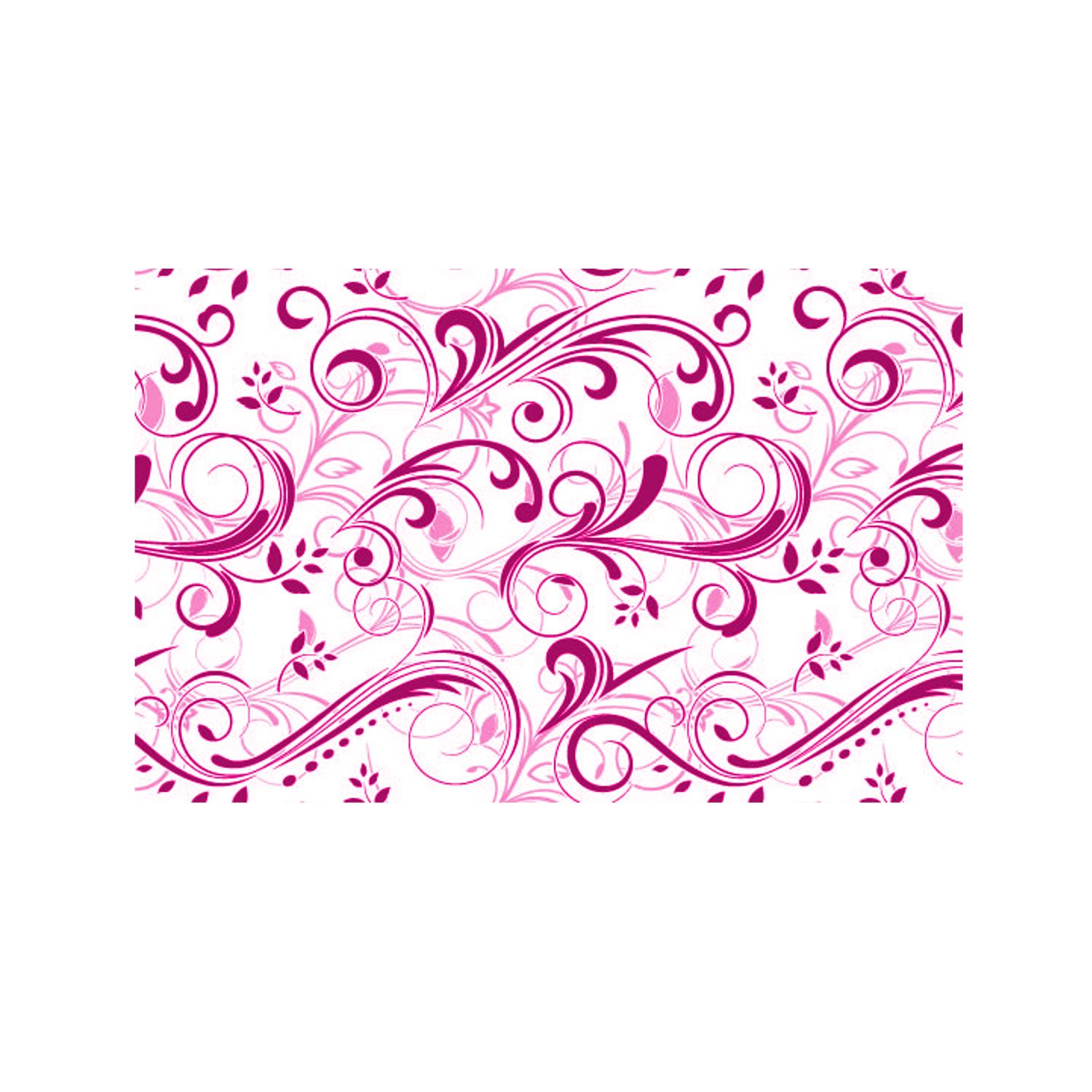

1. Added a layer on top with the solid pink color and changed the Mode to color. This leads to the white and pink image (white background) (see attached). I merged down the the pink layer and then tried inverting hoping to swap the foreground and background color of the image but I learned that is not what invert does.
2. I also tried the colorize tool on the greyscale image. Again, I get to the same pink image with white background (why doesn't colorize change the white color?). Again trying to invert this does not lead to what I am looking for.
I wish I could remember how I did it last time but I was just randomly trying things. I would really appreciate if you can suggest a way to swap the foreground and background colors once I have the pink/white image attached.

I tried
(1) colours->invert, since in your pink version the swirls are lighter than the background, not darker;
(2) colours->colourize,
Hue: 323
Saturation: 50 (unchanged)
Lightness: 41 (to colour the background)
Liam

This is perfect. Thank you so much. I wasn't using the lightness setting.
