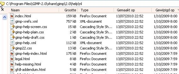

I have just downloaded the new installers for the stable 2.6.10 version and the Gimp Help: http://fotoalbum.seniorennet.be/incl/getimage2.php?imageid=1597195&albumid=18832&typeid=4 and executed them to install 2.6.10 on my Windows XP Pro SP3.

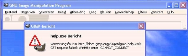

GIMP is doing well except that there is a problem with the Help (and the F1-context-helpkey): http://fotoalbum.seniorennet.be/incl/getimage2.php?imageid=1596062&albumid=18832&typeid=4

When running the intallator I chose Dutch as my language. And as several other people here are not really familiar with English I thought that donwloading the "nl"-help would be OK. I have indeed everything, although a (very) great part is NOT translated in Dutch:
http://fotoalbum.seniorennet.be/incl/getimage2.php?imageid=1596413&albumid=18832&typeid=4

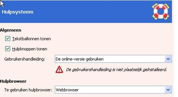

Now seeing the error-message in #1596062 image I think that I should have the "en"-helpversion downloaded? That's what GIMP is searching for and not finding? In the Help-settings it says that the Users's manual is not locally installed:

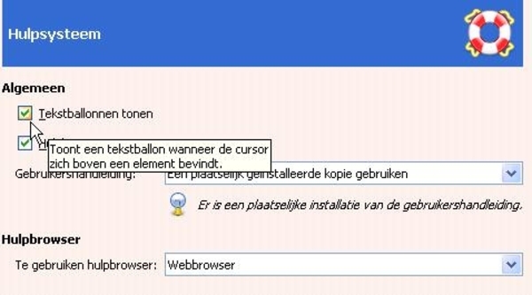

http://fotoalbum.seniorennet.be/incl/getimage2.php?imageid=1597248&albumid=18832&typeid=4
Or otherwise, in order to keep as much as possible of the Dutch translation, I might perhaps better just change the name of the existing directory/folder to "en" instead of "nl" ?? Would that be enough to lure GIMP into giving its help??

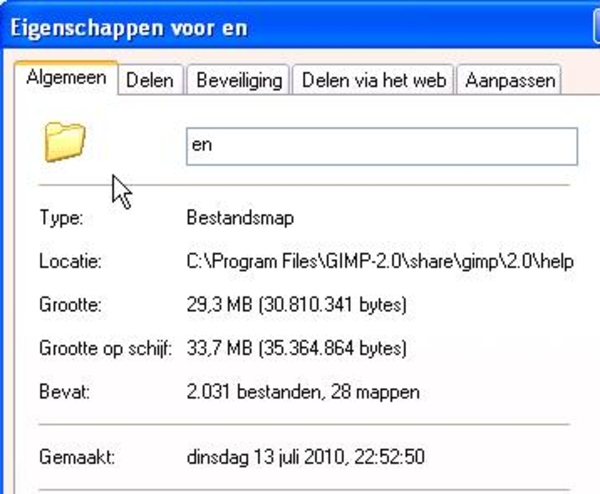

The third image in my yesterday's mail, shows the (Windows) folder where the help was installed: it was definitely "nl". Of course I can still download the "en"-version. I understand that would then be put in a "en"-folder where GIMP would find it.
My clever (?) "otherwise"-proposition was to simply rename the existing "nl"-folder in "en", hoping that GIMP then would show the - partly - translated Dutch help instead of the pure English, which for some people here is like Chinese.

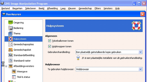

I tried out my clever (!) idea to change the name of the Windows-folder:
C:\Program Files\GIMP-2.0\share\gimp\2.0\help\nl
in which the Help-installer had put the Dutch Help-version from "nl" to "en". And tweaked nothing else than the Preferences - Help panel:
http://fotoalbum.seniorennet.be/incl/getimage2.php?imageid=1603575&albumid=18832&typeid=4
Now the "Help"-buttons and F1 produce no longer an error. They start a browser-window and display there the Help, in the mixed English/Dutch version it is actually in, that is more or less relevant for the context in which he HELP-button or F1-key was used. Sometimes it seems to be necessary to center the focus on a specific detail.

This fortunate discovery, I hope, will help me a lot to better understand GIMP. Below is a line actually copied from my own "gimprc"-file:
(help-locales "en")
Perhaps it would have been orthodox to change this "en" to "nl". But nevertheless my non-standard trick did the job? The "HELP"-buttons and the F1-key do show me the help I ask. From my locally installed html-base:
C:\Program Files\GIMP-2.0\share\gimp\2.0\help\en
http://fotoalbum.seniorennet.be/incl/getimage2.php?imageid=1607415&albumid=18832&typeid=4
As far as I am concerned this case seems closed. Thanks for the help.

Ok, that explains a lot. You changed your settings so that the English Help is always taken, no matter what your locale is. It would be best to change this back to the default. To do that, just remove that line.
