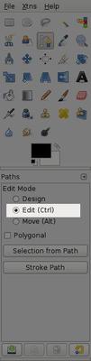

    Now choose “Edit” in the preferences of the paths tool.
    Then click the long line and move it down so border where skin ends and is covered by the cloths. Repeat this step until you get a nice completed path.

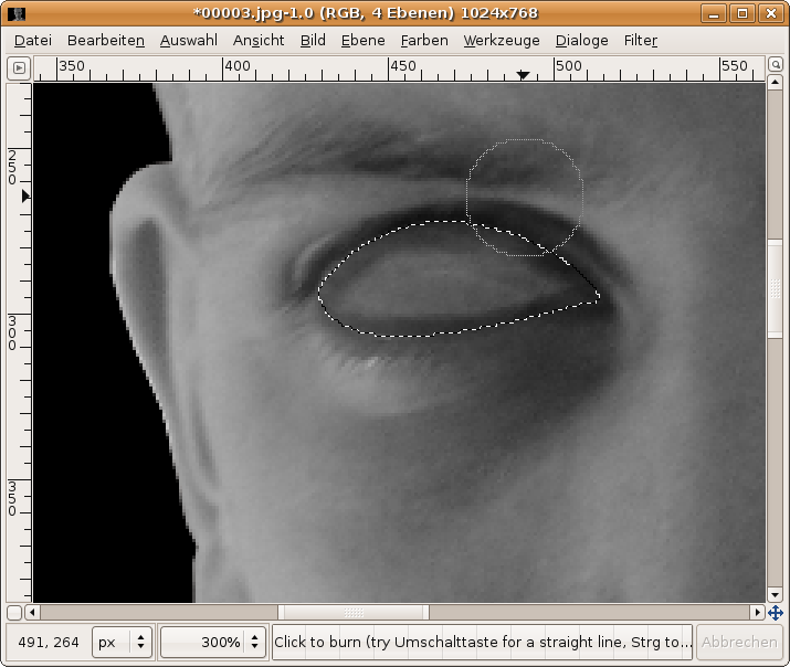

    Let the selection active and activate the dodge/burn-tool. Set “Burn” as option and use a soft brush to paint along the border of the eye. Burn the borders of the eye until the darkness is pretty much the same as in the corner of the eye. See my image to get a feel for this.
  13. 13

I'm on step 6 and I've looked all over GIMP and I can't find anywhere " 'Edit' in the preferences of the paths tool."
I even looked in FILE, PREFERENCES. Can't find any paths preferences...
Help?
