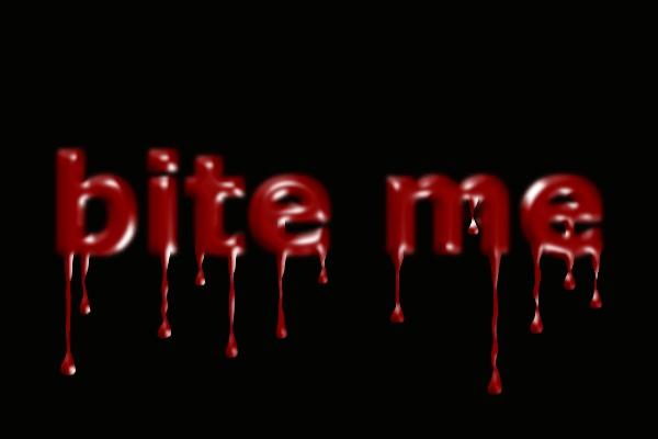

In this tutorial I show you how you can liquify / smelt text or other graphical objects. I'm going to demonstrate this by creating a blood text.
    Make a new file: 600×400 px. White background. Write one or two words with a sans-serif-font (i.e. “bloody GIMP” ;)).
    Line height: ca. -15
    Color of text: #870000 (a dark red)
    Layer / Layer to Image size. After this the text cannot be changed because it is rendered.
    The next technique is optional. The blood looks simply better when your text has rounded corners. We’ve a seperate tutorial for the rounded corners-technique. The technique is very useful. Have a look at it.
    These are the quick steps to get rounded corners on this text:
    - Apply Filter / Gaussian Blur
    - 10px
    - Repeat the filter by Pressing CTRL+F
    - Repeat it again
    - Choose Colors / Curves, top left choose Alpha as channel. Move the point at the bottom to the middle, do so with the point that is at the top right. You’ll see immideate changes in the picture. Do this until you have nice rounded off corners.
    Create a new layer and choose the pencil-tool. Make sure the color is the same as before #870000.
    Paint even vertical lines down now. (You get exact lines when clicking a single dot someqhere into the text – this is the starting point – then hold SHIFT and set the endpoint). Do this a few times as seen on the image below.
    The strength of the pencil should be 7.
    After being satisfied with the lines click “Merge down” by clicking right in the layers dialog. The Text and the lines should then be on a single layer.
    To make the lines look like a part of the text we use the Liquify-Filter. Filters / Distorts / IWarp. Choose “grow”.
    Deform radius: 9
    Deform amount: 0.26
    All Work is done in the preview-window of this filter: Now first work on the area where the ‘blood’ is coming out of the text and running down. Click and hold your mouse down at the exitpoint of the blood of the text and make small circular movements. The hard edges look more as they would have been a part of the text. Repeat this for every line.
    The next step are the endings of the lines. They should look like drops in the end, do this with the same teqchnique as with the exitpoints.
    After that use “shrink”. Now shrink the middle parts of the lines so that they become much thinner. To do this move the mouse (while holding down the mousebutton) from top to bottom until you find it thin enough. It should be uneven to look real!
    You should the have a result of something like that:
    If your satisfied with the result you’re done ;)

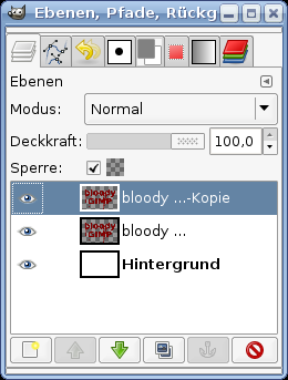

    Duplicate the layer with the blood and click the “Lock”-Button in the layers dialog (it is found above the layers). It’s called “Sperre” in the image below.
    Rightclick in the layers dialog “Selection from Alpha”. Then click the Channels dialog (Dialogs / Channels). Add a new channel: “Initialize from selection”.
