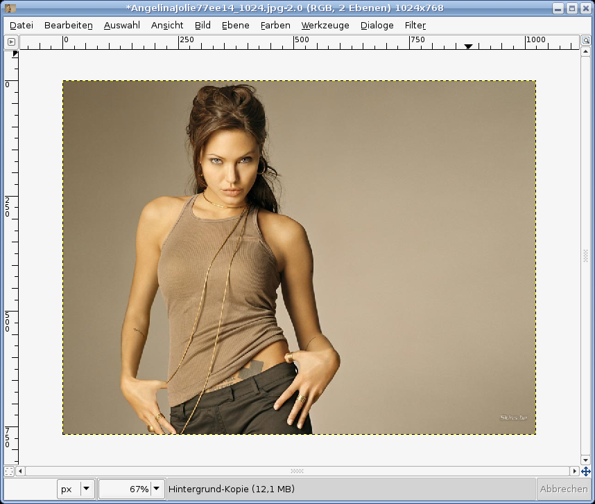

    First of all we’ve to mask Angelina (free her body from the background). There are many ways to do this, one easy way is to use the paths-tool. Click B, thats the hotkey for the bezier-paths-tool. Check the “Polygon”-Option. Duplicate the picture and make the copy invisible by clicking the eye-icon in the layers-dialog.
    In the layers-dialog activate the background-layer, click right and choose “Add Alpha-Channel”.
    Your layers should look like this now:
    Be sure to have the Paths-Tool active. Now start to click in the left bottom (where her hand is). Zoom the picture in to 300%, now click in small intervals along her skin. When encountering edges do very small click intervals. do this for the whole picture. First only for the outer part.
    When you finished you need to hold CTRL and click the first point you set. This is to complete your path – it is completed as seen on the picture below.
    If you did some points wrong or change anything in the path you can do this now by moving the single points. By holding CTRL and scrolling the wheel on your mouse you can zoom out/in. After you’re satisified with your path hit ENTER and the path becomes an active selection.
    The part is now selected. Hit CTRL+I to invert the selection or go to Selection / Invert and remove the selected part (hit DEL):

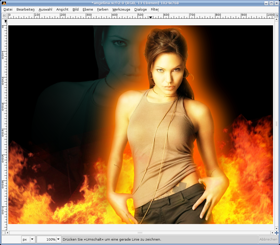

    Thats it! ;) Have fun doing your own wallpapers.
