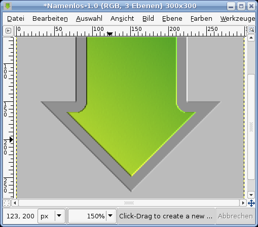

    - Add a news layer.
    - Selection / Shrink : 15px.
    - Choose #b1d631 as FG color and #55a32a as BG color.
    - Fill the layer susing the gradient tool. Draw the gradient from the left bottom to the top right.
    - decativate the selection.
    Now you should have this picture.
